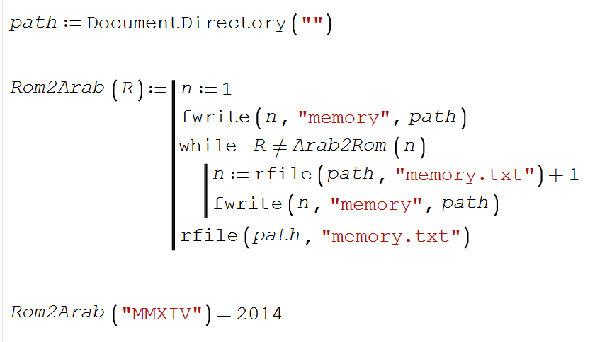

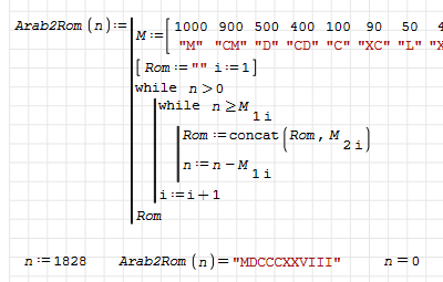

Really it's a very strange bahavior (a bug ?), because the value of variable n is cleared when function returns from Arab2Rom()
So, a solution is to use functions fwrite() and rfile() to save the value of n on a file as a memory:
See the atachment with the solution: Rome-Arab SOLVED.sm (41,21 КиБ) скачан 1528 раз(а).
best,
Oscar
best,
Oscar

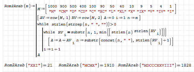

Rom2Arab.sm (293,29 КиБ) скачан 1511 раз(а).

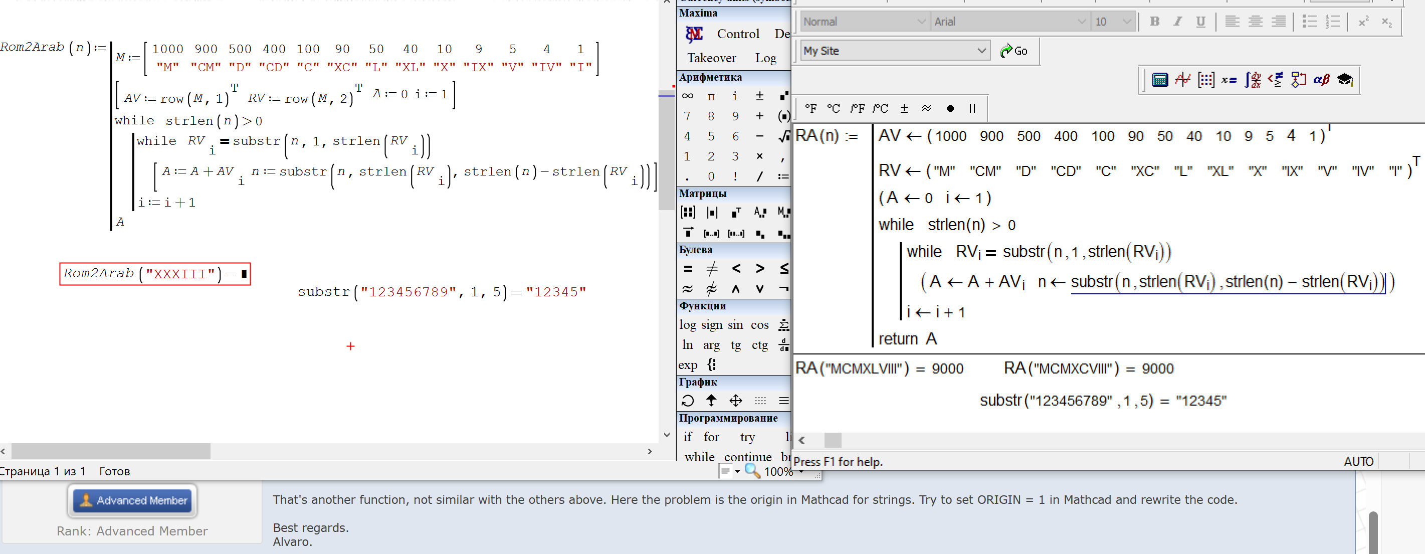

That's another function, not similar with the others above. Here the problem is the origin in Mathcad for strings. Try to set ORIGIN = 1 in Mathcad and rewrite the code.
WroteWroteThanks!
But this have an error too!
