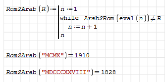

Why doesn't the cycle end?
See please the attachRome-Arab.sm (40.3 KiB) downloaded 1524 time(s).

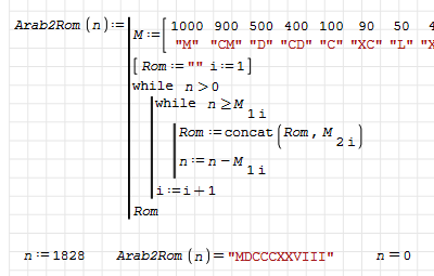

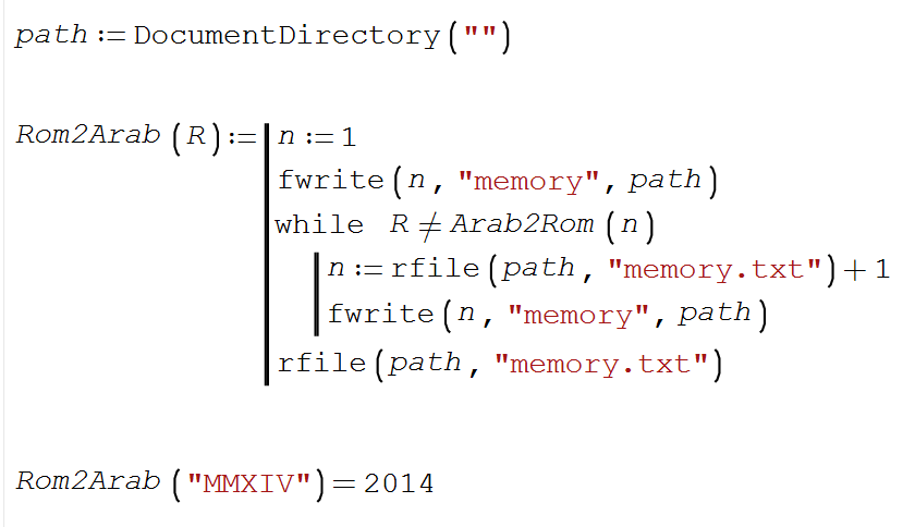

Really it's a very strange bahavior (a bug ?), because the value of variable n is cleared when function returns from Arab2Rom()
So, a solution is to use functions fwrite() and rfile() to save the value of n on a file as a memory:
See the atachment with the solution: Rome-Arab SOLVED.sm (41.21 KiB) downloaded 1528 time(s).

Hi. In Arab2Rom(n) you modify n.
That's not good practice. This is a workaround for such cases.

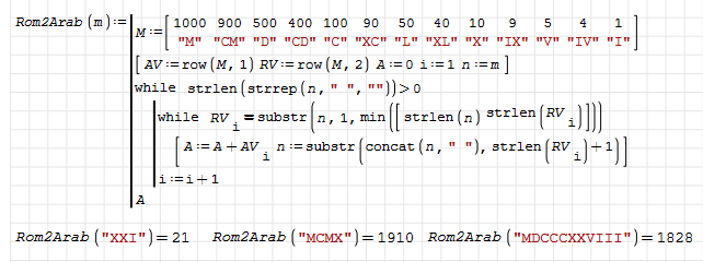

But this have an error too!
Rom2Arab.sm (293.29 KiB) downloaded 1511 time(s).

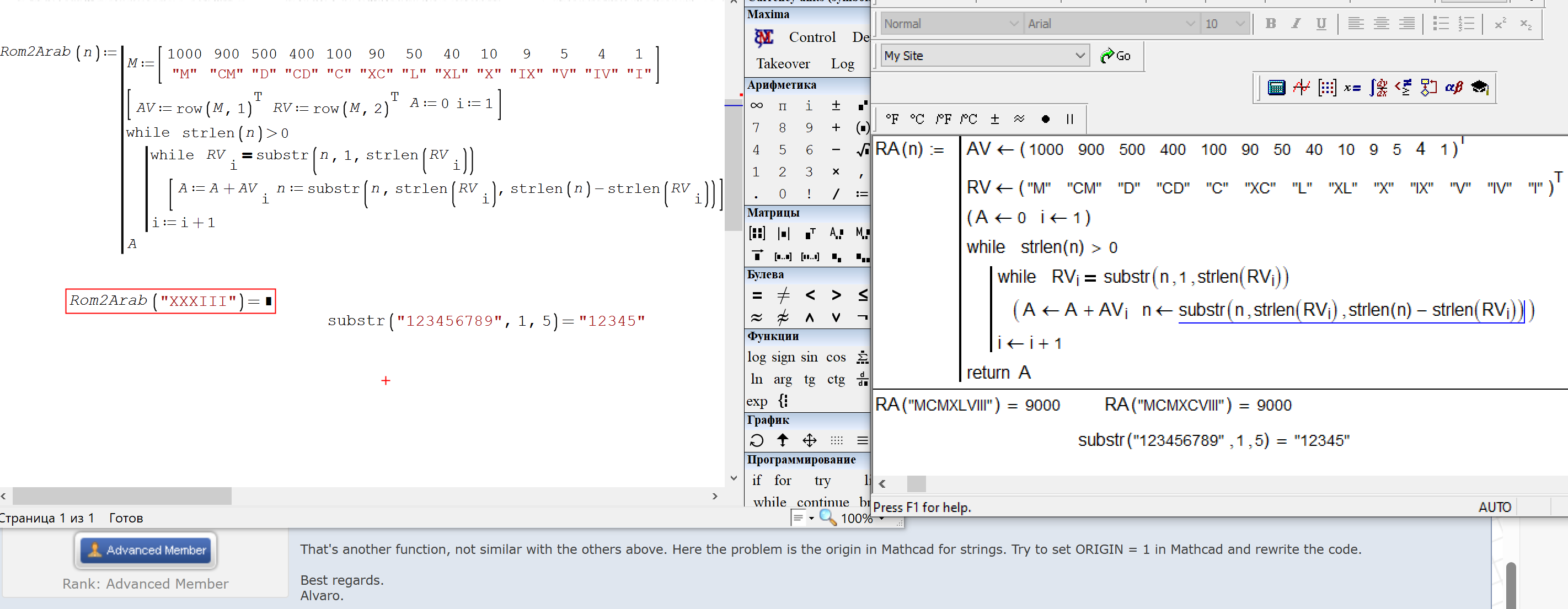

#5 Posted: 10/19/2023 1:52:56 AM
1,139 likes in 1,805 posts.
Thanks!
That's another function, not similar with the others above. Here the problem is the origin in Mathcad for strings. Try to set ORIGIN = 1 in Mathcad and rewrite the code.
#6 Posted: 10/19/2023 2:13:24 AM
Valery Ochkov
Valery Ochkov
67 likes in 713 posts.
Thanks!
#7 Posted: 10/19/2023 2:43:57 AM
This is one way.
Valery Ochkov 10/19/2023 2:49:00 AM

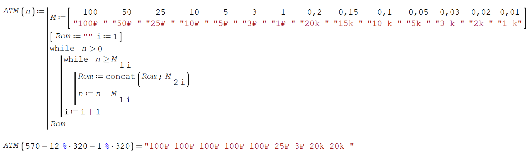

#9 Posted: 10/23/2023 12:30:24 AM
Valery Ochkov
Valery Ochkov
My salary in 1980
ATM-SU.sm (6.29 KiB) downloaded 1519 time(s).
