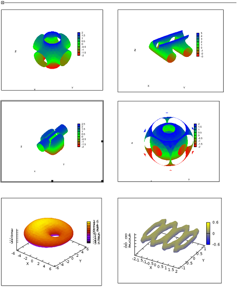

#4 Опубликовано: 29.01.2017 16:56:41
Fridel Selitsky
Fridel Selitsky
Two surfaces are taken from the site
http://xrt.wikidot.com/gallery:implicit
The calculation algorithm:
1.Find the line of intersection of the given surface with the plane Z=0
2.Through each point hold the plane x1 = C and find the line of intersection of that plane with a given surface.These lines represent a given surface.
Davide Carpi 30.01.2017 09:18:00

#7 Опубликовано: 31.01.2017 17:50:55
Fridel Selitsky
Fridel Selitsky
The tube in the form of a line of intersection of the cylinder and the torus (See post 7)
http://en.smath.info/forum/yaf_postst2307_Method-A-B--Draghilev-and-animation-spatial-mechanisms.aspx
Time calculation, 9 min.
Villarceau 9.sm (39,38 КиБ) скачан 1297 раз(а).
Davide Carpi 01.02.2017 05:58:00

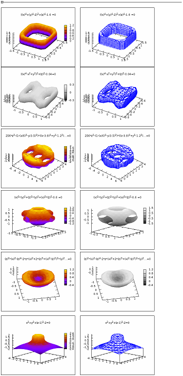

#13 Опубликовано: 06.02.2018 03:56:52
Fridel Selitsky
Fridel Selitsky
Implicit surfaces in Maxima
ImplicitMaxima.sm (363,82 КиБ) скачан 1357 раз(а).
frapuano 06.02.2018 04:34:00, Martin Kraska 06.02.2018 04:59:00, Radovan Omorjan 06.02.2018 06:22:00

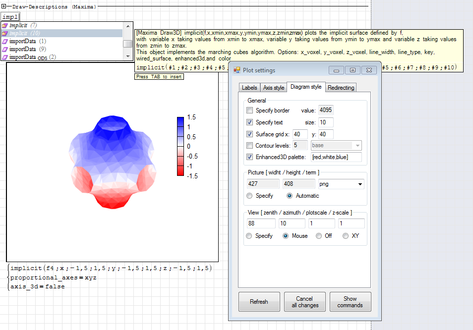

#14 Опубликовано: 06.02.2018 05:06:49
Nice examples!
Just some remarks for those who want to play around with Maxima Draw.
  • Instead of Image region with Draw() command you can use Maxima Draw3D region with interactive zoom, rotation and resize and a settings dialog.
    Insert-> Maxima-> Draw3D
  • The performance isn't overwhelming, as the image is recalculated for each interaction.
  • The snippet "draw" provides help texts for the available draw commands and options.
  • Follow the link in my signature to see how to configure SMath with Maxima.
ImplicitMaxima_Kr.sm (492,51 КиБ) скачан 1399 раз(а).
Вячеслав Мезенцев 06.02.2018 06:15:00, Radovan Omorjan 06.02.2018 06:22:00, frapuano 06.02.2018 10:28:00, Fridel Selitsky 06.02.2018 05:08:00
