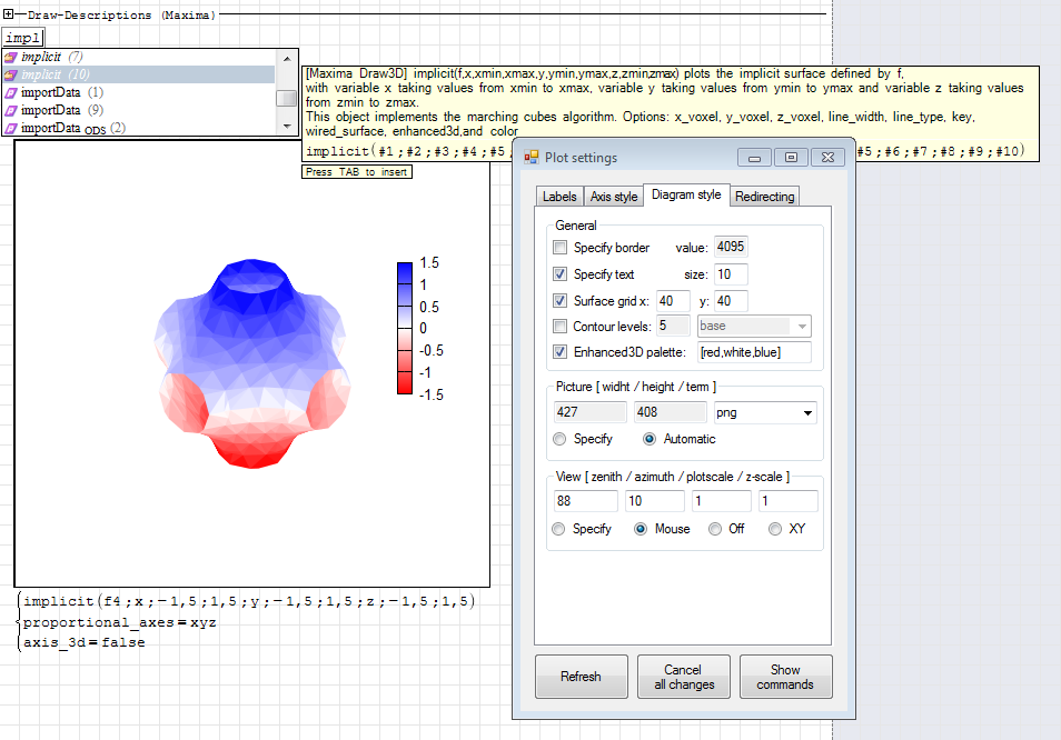

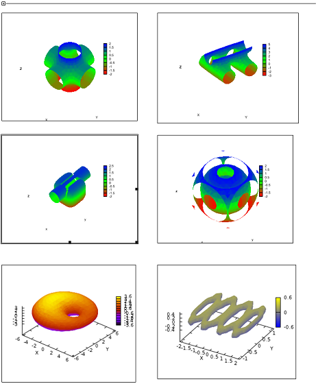

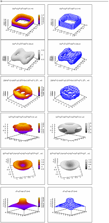

#14 Posted: 2/6/2018 5:06:49 AM
Nice examples!
Just some remarks for those who want to play around with Maxima Draw.
ImplicitMaxima_Kr.sm (492.51 KiB) downloaded 1399 time(s).
![2018-02-06 08_55_49-SMath Studio - [ImplicitMaxima.sm_].png](/en-US/files/Download/BoD4rH/2018-02-06-08_55_49-SMath-Studio---[ImplicitMaxima.sm_].png)
- Instead of Image region with Draw() command you can use Maxima Draw3D region with interactive zoom, rotation and resize and a settings dialog.
Insert-> Maxima-> Draw3D - The performance isn't overwhelming, as the image is recalculated for each interaction.
- The snippet "draw" provides help texts for the available draw commands and options.
- Follow the link in my signature to see how to configure SMath with Maxima.
