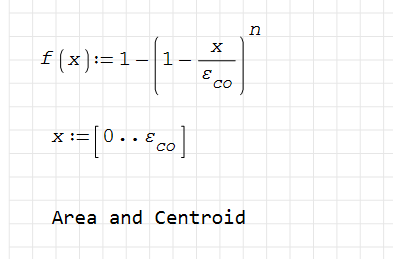

Here's my solution - done by hand, as it is straightforward using a simple substitution.
(I'd upload an image but I can't see how to do that!)
Area&Centroid.sm (13,22 КиБ) скачан 1361 раз(а).

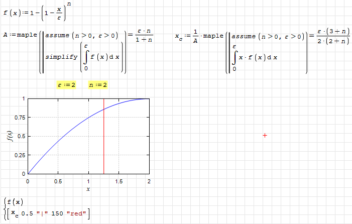

WroteHow to find area and centroid
Make your function parametric f(x,e,n), plot some typical.
f(x,0.5,0.5) ... f(x,0.5,2) ... f(x,0.5,3)
Discretize the range(s) of interest.
... suite for: Area, Perimeter, Centroid
