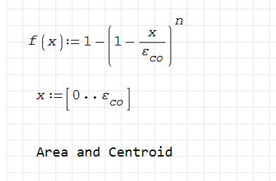

How to find area and centroid
question_20230711.sm (2.88 KiB) downloaded 1273 time(s).

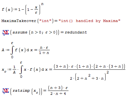

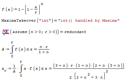

Ac.sm (6.17 KiB) downloaded 1228 time(s).
Make your function parametric f(x,e,n), plot some typical.
f(x,0.5,0.5) ... f(x,0.5,2) ... f(x,0.5,3)
Discretize the range(s) of interest.
... suite for: Area, Perimeter, Centroid

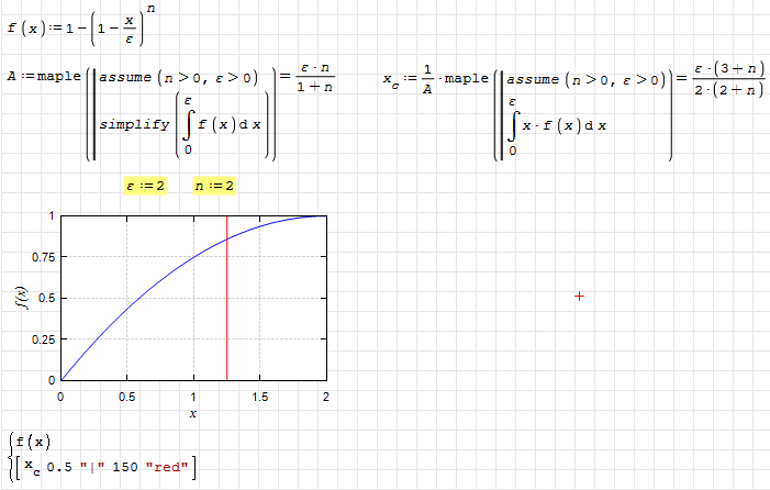

#5 Posted: 7/11/2023 9:17:41 AM
1,554 likes in 1,864 posts.
Ac (uni).sm (8.4 KiB) downloaded 1268 time(s).

Maxima is a bit lazy with simplification...
Ac.sm (7.08 KiB) downloaded 1227 time(s).

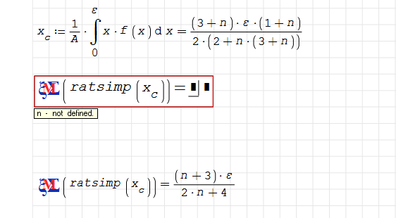

why can't i do right that?
what's the problem?
