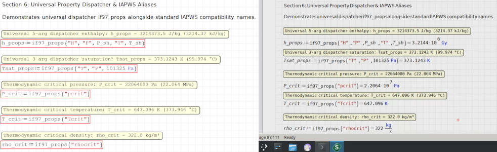

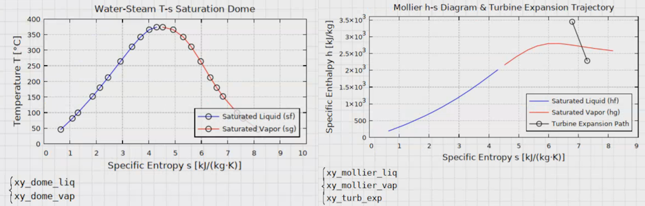

Many functions for water and steam properties are exposed. Library is unit-aware and outputs in standard SI units.
OS agnostic
Archive contains .zip plugin, .sm artifact, detailed documentation and source files
The problem I am facing is with few functions which work in my Linux but do not work in Windows. Perhaps someone can sort it out

Learned something new
• Replaced all calls to System.String.Trim() in IF97Wrapper.cs:1024-1034 and Unit.cs:112 with the index-based scanner StripQuotes(string s).
• Binary verification confirmed 0 instructions and 0 metadata tokens reference Trim in IF97Wrapper.dll.
Should resolve previous errors on windows
