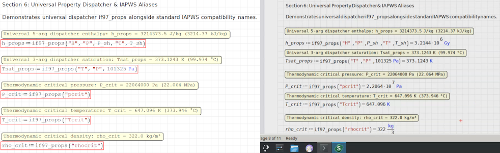

The problem I am facing is with few functions which work in my Linux but do not work in Windows. Perhaps someone can sort it out

Learned something new
• Replaced all calls to System.String.Trim() in IF97Wrapper.cs:1024-1034 and Unit.cs:112 with the index-based scanner StripQuotes(string s).
• Binary verification confirmed 0 instructions and 0 metadata tokens reference Trim in IF97Wrapper.dll.
Should resolve previous errors on windows

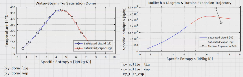

Completely updated OS agnostic plugin
Check /dist/*.zip for ready to use plugin
Code is hosted at github https://github.com/defencedog/smath-devel/tree/main/plugin/IF97_src_win
PDF: https://github.com/defencedog/smath-devel/blob/main/plugin/IF97_src_win/examples/if97_steam_tables.pdf
