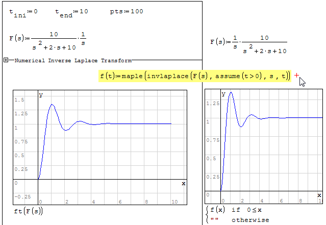

Hi, this is a snippet for numerical inverse Laplace transform. You can find time response of a system expressed in F(s) form. enjoy
This 5 years old document does not work 6179.
Here is the Maple companion.

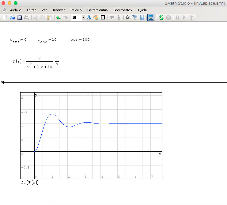

Only a very little detail to fix this 5 years old document: declare F(s) and change the last line on snippet:
ft( "F(s" ) = augment(t,ft)
for
ft() = augment(t,ft)

#17 Опубликовано: 28.08.2017 11:01:53
You can download the updated version from here
... that's only several pages long of HTML code.
No work sheet. Best is to upload WS in the forum.
For "Laplace stuff", better use maple(,) as show above.
Cheers, Jean
Yes, and also it’s possible use f(t)=Maxima(ilt(F(s),s,t)) but it’s interesting show how you can implement inverse Laplace of a function in SMath.
P.D. The symbolic form of f(t) obtained from ilt() it’s more “elegant” than maple version
