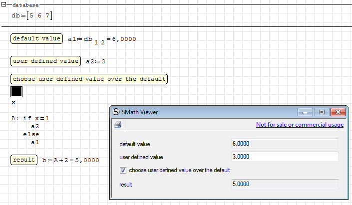

I use Smath Viewer - *.exe
How to make it possible to enter data in a field that receives the calculated data,
Explanation in the picture

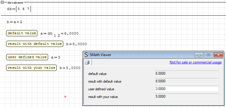

#4 Опубликовано: 29.10.2017 15:04:46
I understand the point, as for now the only way is to change the logic of your script (f.e. creating a tab with database-driven inputs, another with user-driven inputs) or to use controls (checkbox, combobox...) to drive the behavior

Thank you, Davide Carpi!
Yes, I also thought about this solution.
If there are no other suggestions, I will use your proposed solution.
