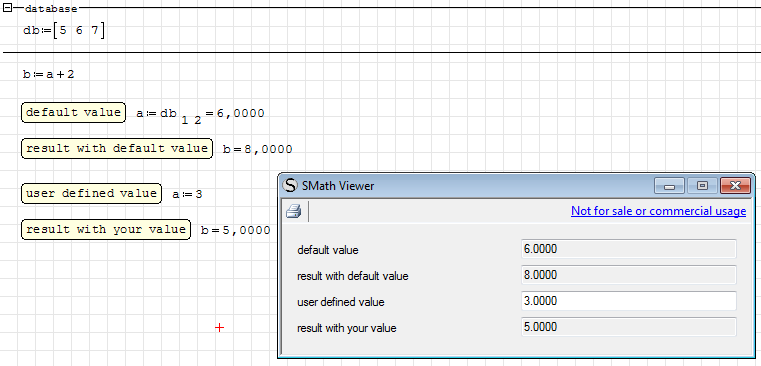

I use Smath Viewer - *.exe
How to make it possible to enter data in a field that receives the calculated data,
Explanation in the picture

Hello Davide Carpi,
For example,
the data retrieved from the database or a calculation
and the User can change this value or accept the given value.
(In other words - the default value)
as a variable a, as shown in the picture above, because we initially set the value that the user can change it

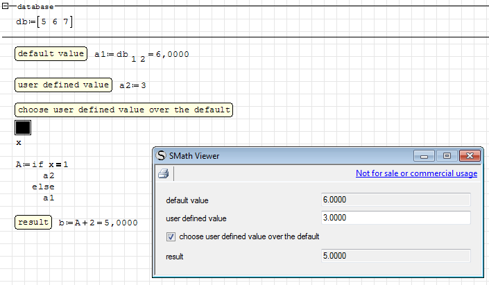

I understand the point, as for now the only way is to change the logic of your script (f.e. creating a tab with database-driven inputs, another with user-driven inputs) or to use controls (checkbox, combobox...) to drive the behavior

Thank you, Davide Carpi!
Yes, I also thought about this solution.
If there are no other suggestions, I will use your proposed solution.
