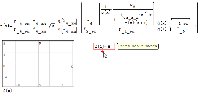

Who has faced such a problem, how can it be solved?
Project from below
Poverochnyjj raschjot ehzhektora.sm (84,1 КиБ) скачан 1179 раз(а).
#2 Опубликовано: 12.02.2020 12:07:47
"result above max ..." has no pertinent meaning in your project.
If you attempt "roots" on the numerator only ... "Units don't match"
No need to go further ... zap the units in the project.

I made a mistake, there should be a solve function, in this place the same error
#4 Опубликовано: 12.02.2020 14:57:49
Same answer: Units don't match.
How can you solve what you can't plot or evaluate ?

why do you use 0.2 and 0.5?
#7 Опубликовано: 14.02.2020 13:57:29
Joki,
Martin could have drawn the two curves and graphically estimated the two solutions
#8 Опубликовано: 14.02.2020 14:52:49
Joki720
Joki720
0 сообщений из 12 понравились пользователям.
The solution must be automatic, plotting make and evaluating it is not appropriate
#9 Опубликовано: 14.02.2020 19:34:05
OK ... don't plot => find min/max.
Don't you need a road to drive the car from point A to point B ?
#10 Опубликовано: 14.02.2020 22:56:17
Common from ill posed construction.
Consider yellow up until you can plot that system(x,y):= ....
from there it should be solvable.
Poverochnyjj raschjot ehzhektora [zap Units, define the Undefined ...].sm (94,03 КиБ) скачан 1006 раз(а).

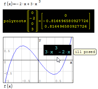

Always avoid ill posed polynomials.
