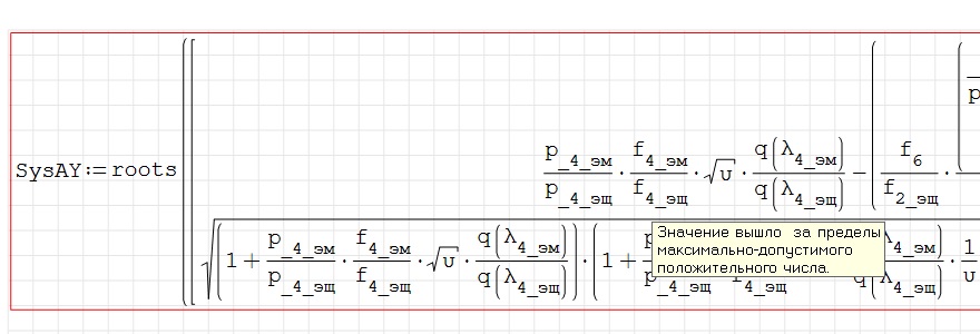

The value went beyond the maximum allowed positive number
The value went beyond the maximum allowed positive number - the value went beyond the maximum allowed positive number, error in the solve function - Messages
#1 Posted: 2/12/2020 10:38:12 AM
Joki720
Joki720
0 likes in 12 posts.
Who has faced such a problem, how can it be solved?
Project from below
Poverochnyjj raschjot ehzhektora.sm (84.1 KiB) downloaded 1179 time(s).

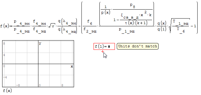

#2 Posted: 2/12/2020 12:07:47 PM
"result above max ..." has no pertinent meaning in your project.
If you attempt "roots" on the numerator only ... "Units don't match"
No need to go further ... zap the units in the project.
#3 Posted: 2/12/2020 12:38:24 PM
Joki720
Joki720
I made a mistake, there should be a solve function, in this place the same error
#4 Posted: 2/12/2020 2:57:49 PM
Same answer: Units don't match.
How can you solve what you can't plot or evaluate ?

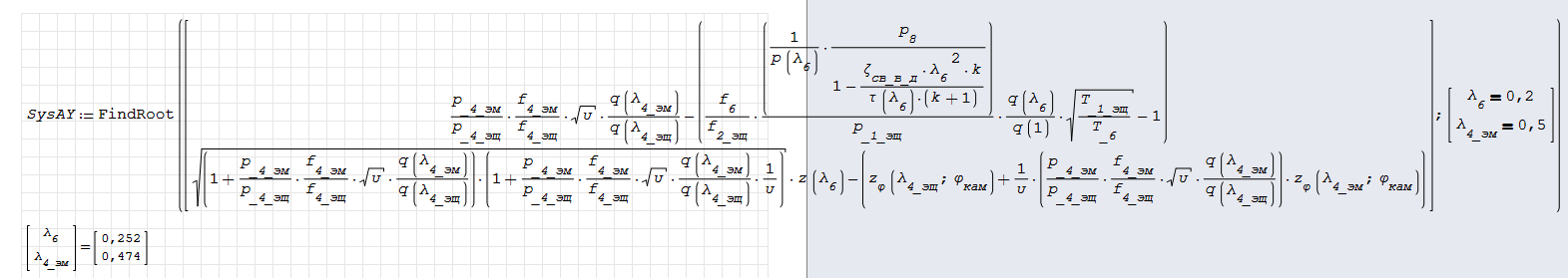

#5 Posted: 2/13/2020 7:44:15 AM
1,361 likes in 2,275 posts.
You can use the function FindRoot() from the Nonlinear Solvers plugin. The function automatically assigns the solution to the variables.
Единицы измерения здесь не при чем.
2020-02-13 11_38_00-SMath Studio 0.99.7251 - [Poverochnyjj%20raschjot%20ehzhektora.sm_].png
Joki720 2/14/2020 1:06:00 PM
#6 Posted: 2/14/2020 1:09:51 PM
Joki720
Joki720
why do you use 0.2 and 0.5?

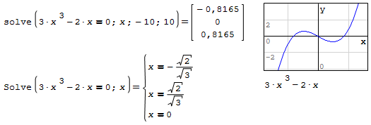

#11 Posted: 2/15/2020 6:37:16 AM
Martin could have drawn the two curves and graphically estimated the two solutions
The solution must be automatic, plotting make and evaluating it is not appropriate
Go on dreaming. If you are in non-linear systems and you can't find a symbolic solution (Maxima's Solve() got stuck when I tried) then you need numerical procedures for solution. These always need an initial guess (Newton-Raphson) or a search region (bisection). The various procedures just differ in how efficient or how robust they are. Some of them may have quite impressive radii of convergence for particular systems but none has infinite radius for all systems.
Furthermore, there remains the problem of uniqueness of a solution. The only solvers in SMath capable of providing multiple solutions are the
  • solve() finds all solutions of a single equation within a given range
  • Solve() from the Maxima plugin, which finds symbolic solutions.
Blatt21.sm (5.23 KiB) downloaded 1194 time(s).
#12 Posted: 2/15/2020 12:10:50 PM
Quite right and not enough wrt complex roots.

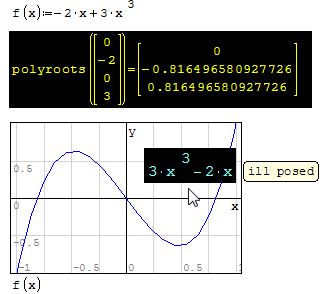

#13 Posted: 2/15/2020 5:54:43 PM
Always avoid ill posed polynomials.
