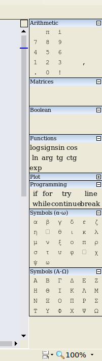

SMKa
The missing symbols
I tried to:
See if i have everything enabled in Extensions Manager (yes)
install all sorts of font packages (Libre Office Math shows everything)
reboot
search for missing files
walk backwards on full moon
reboot again
search if anyone else had same problems (could not find any)
etc.
what could cause the problem and how to fix it?
Ubuntu 20.04 LTS
Downloaded the SMathStudioDesktop.0_99_7030.Mono.tar.gz
I have installed mono-complete using these instructions: https://www.mono-project.com/download/stable/#download-lin
Only errors I got were:
Installing mono (in the installation phase "sudo apt update" ) gave this error:
Skipping acquire of configured file 'main/binary-i386/Packages' as repository 'https://download.mono-project.com/repo/ubuntu stable-focal InRelease' doesn't support architecture 'i386'
"Could not set X locale modifiers" when launching SMath on terminal
fixed it with
rm -Rf ~/.config/.mono (https://github.com/mono/mono/issues/18238)
Both, before and after, the symbols were missing.

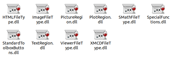

The "plugins" folder

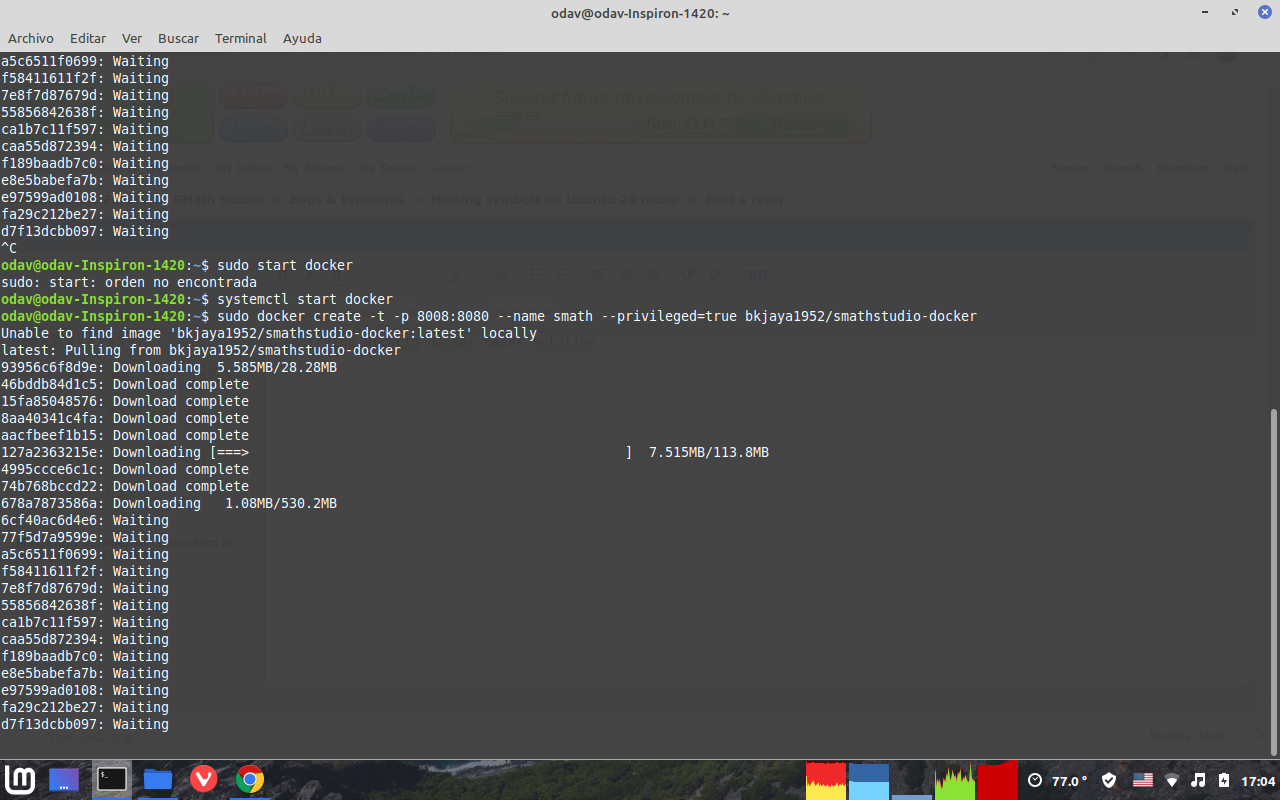

I have found a solution for those who can't use SMath on Linux distros or it's not working for some reason.
Steps:
(Just use Docker)
I follow this tutorial: https://github.com/bkjaya2020/smathstudio-docker
As a Fedora 32 user, I just did:
1. sudo dnf install docker
2. systemctl start docker
3. sudo docker create -t -p 8008:8080 --name smath --privileged=true bkjaya1952/smathstudio-docker (it would take some minutes)
4. sudo docker start smath
5. in the browser, go to http://localhost:8008/
That's it =)
SMath will show there fully functional!
#10 Опубликовано: 01.07.2020 18:09:51
otto daniel
otto daniel
I am trying Nicacio docker based solution and its making me download a lot of data, will report back if i am able to run it, but i dont think this is the most efficient solution, there is something weird happening on smath that even on the .msi version tunning through wine the symbols dont show

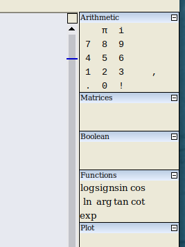

#14 Опубликовано: 02.10.2020 17:38:52
Ruben Sidranski
Ruben Sidranski

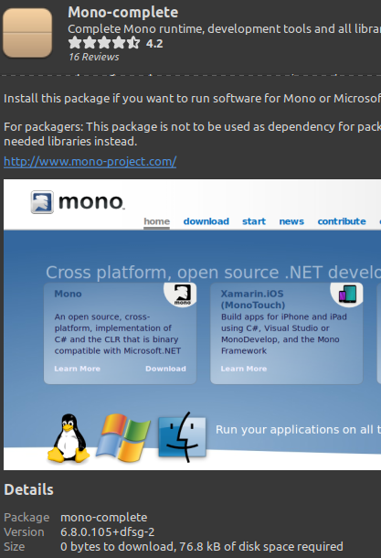

I am just dabbling and trying to get into Linux. I installed Linux Mint 20 - Cinnamon and was looking for the mono-complete package
  • the version available is 6.8, not 6.10 per the https://www.mono-project.com/
Does this solve anything for others? A set of instructions for us GUI people would be appreciated if this fixes things
PS:
  1. I uninstalled mono-complete from the machine
  2. I ran the commands in a terminal box from https://www.mono-project.com/download/stable/#download-lin
  3. My system said that it needed to be updated and one of the components said "mono 6.12.0.101" (no screenshot)
  4. still have the graphics issue
PPS:
I shut down the machine last night and turned it on this morning. There was an update for Mono, 6.12.101. I let it install (not sure if it's complete. I still have the graphical issue. Then re-ran
Цитата
sudo apt install mono-devel
Thinking out loud ... Could it be a font issue?
[UPDATE]
Not a font issue. I copied my windows 10 fonts directory into my home directory home/{USR}/.local/share/fonts... unless I did that wrong

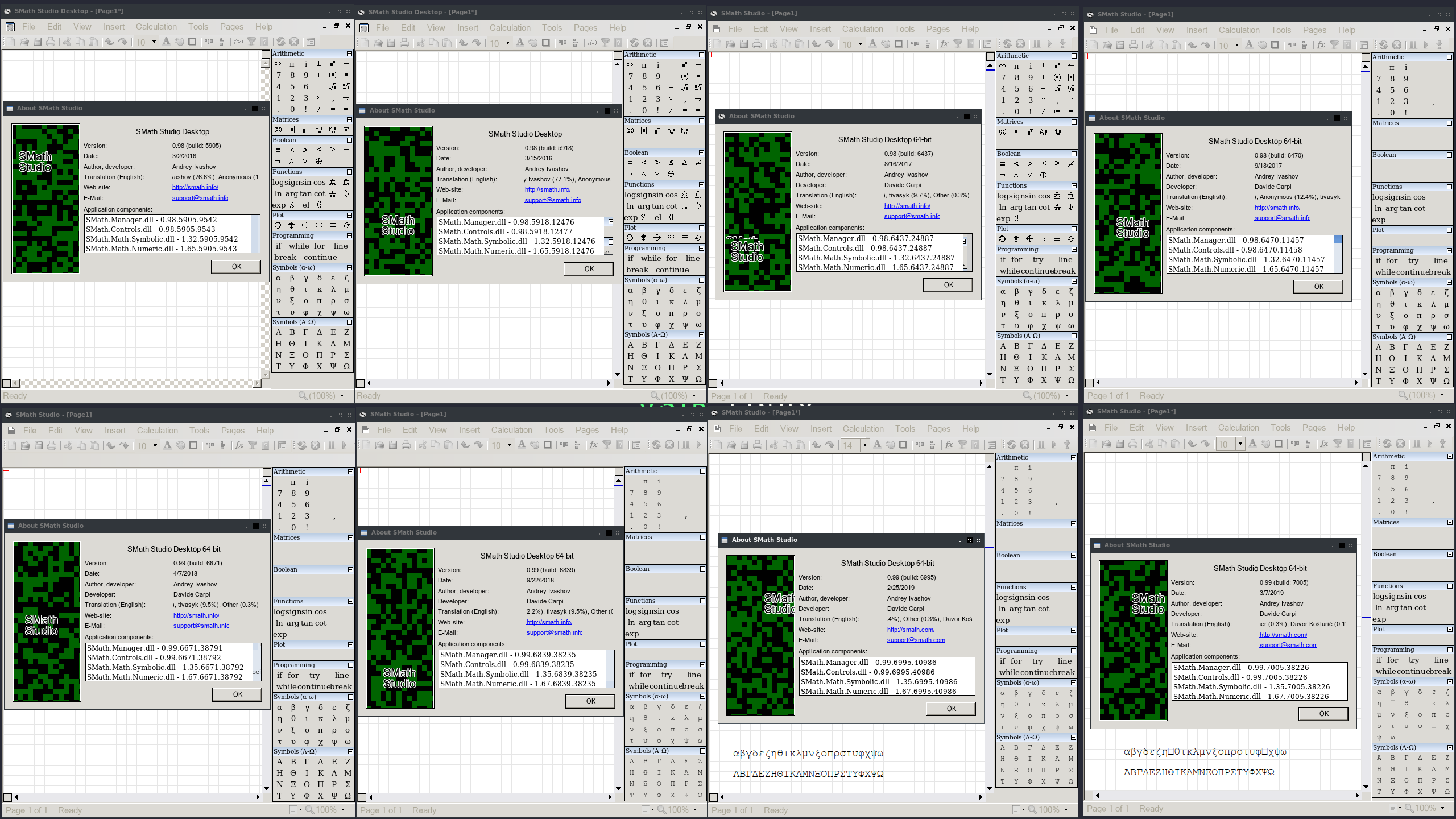

#15 Опубликовано: 13.10.2020 22:01:36

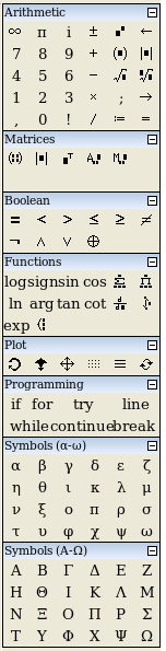

I have investigated the sidebar issue with previous builds.
Below I listed what happened to sidebar step by step on Linux Mono builds.
Sorry for the big picture but I had to prtscr that so everything can be seen in one screen.
1- It was build 5905 when everything was fine.
2- When new functions added to matrices sidebar on build 5918, they didn't show up. But they are clickable.
3- Last working version beside new matrices functions was build 6437.
4- Starting from build 6470, a lot of sidebar buttons are missing. But sidebar button fonts are big on these builds.
5- Last big font but missing buttoned sidebar build was 6671.
6- On and after build 6839, buttons had slim fonts. This build had same amount of non-missing items as previous build and all alphabet items are shown.
7- The last full greek alphabet version was build 6995.
8- After build 7005, two alphabet buttons are missing too. These two additional they are not presented on previous builds.
You can not use them on SMath canvas either. They give only rectangle on regions not characters.
Andrey Ivashov 14.10.2020 01:56:00

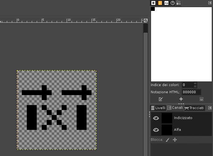

BTW: Today I am using PNG icon (vectorumno.png) instead of GIF, but we still have the issue on Linux... Actually all icons became invisible on 6470 because I've converted them to PNG format.
Peraphs if it's not something codec-related might be the size of the container wrt the size of the image (just an idea).
About these two images in particular seems they have different BG/transparent colors (white the old, black the new) and different color maps.
2020-10-14 14_27_05-[vectorumno-2477] (importata)-1.0 (Colore indicizzato interi a 8 bit gamma, GIMP.png
2020-10-14 14_26_45-[vectorumno-321] (importata)-4.0 (Colore indicizzato interi a 8 bit gamma, GIMP .png
Andrey Ivashov 14.10.2020 10:41:00

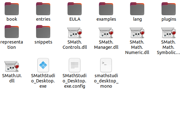

Question, on Linux, am I suppose to double click on "SMathStudio_Desktop.exe" or "smathstudio_desktop_mono" {no extension}. My version of "smathstudio_desktop_mono" is dated 05/30/2013. The following is what's in that file

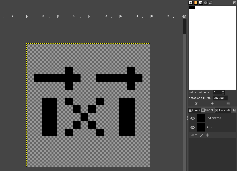

#20 Опубликовано: 14.10.2020 13:17:33

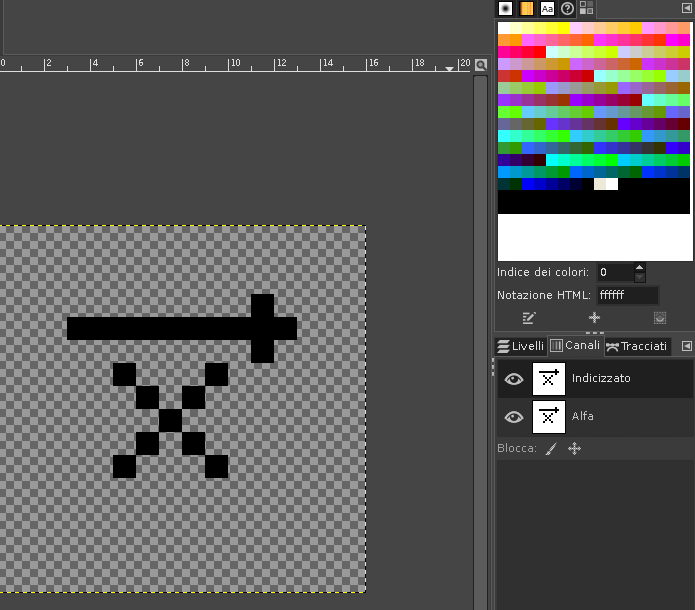

Please, could you check PNG image as well? Does it have the same colors?
the PNG file has 2 colors (black and transparent black), however PNG format has alpha channel while GIF has just transparency. Transparency on black color might be the problem in mono?
2020-10-14 15_37_01-[vectorumno] (importata)-1.0 (Colore indicizzato interi a 8 bit gamma, GIMP buil.png
we can try if these works better (32bit and 32bit deinterlaced made with paint.net)
