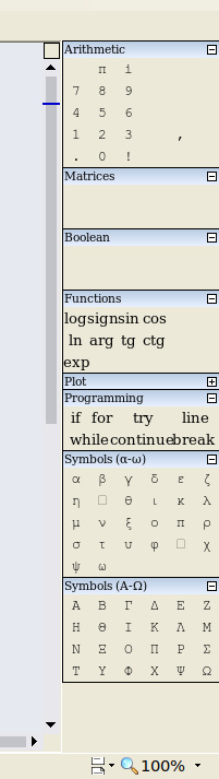

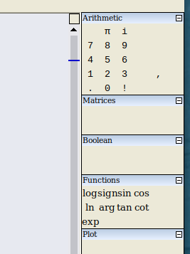

The missing symbols
I tried to:
See if i have everything enabled in Extensions Manager (yes)
install all sorts of font packages (Libre Office Math shows everything)
reboot
search for missing files
walk backwards on full moon
reboot again
search if anyone else had same problems (could not find any)
etc.
what could cause the problem and how to fix it?
Ubuntu 20.04 LTS
Downloaded the SMathStudioDesktop.0_99_7030.Mono.tar.gz
I have installed mono-complete using these instructions: https://www.mono-project.com/download/stable/#download-lin
Only errors I got were:
Installing mono (in the installation phase "sudo apt update" ) gave this error:
Skipping acquire of configured file 'main/binary-i386/Packages' as repository 'https://download.mono-project.com/repo/ubuntu stable-focal InRelease' doesn't support architecture 'i386'
"Could not set X locale modifiers" when launching SMath on terminal
fixed it with
rm -Rf ~/.config/.mono (https://github.com/mono/mono/issues/18238)
Both, before and after, the symbols were missing.

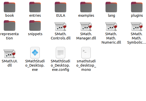

The "plugins" folder
#2 Posted: 5/24/2020 11:08:27 AM
1,443 likes in 2,936 posts.
Thank you for reporting the issue. The problem is about drawing images rather than displaying fonts (the missing buttons are all images), therefore I think the problem is about some missing dependancy or the mono version

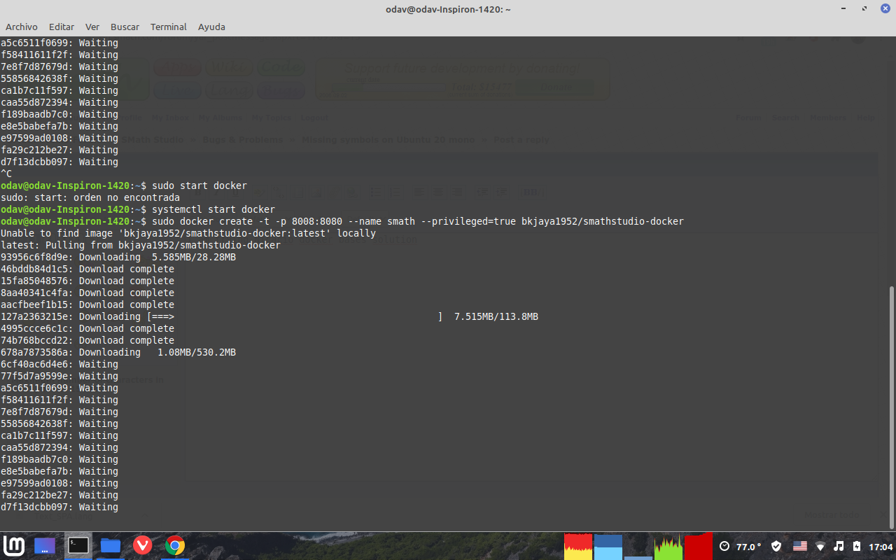

I have found a solution for those who can't use SMath on Linux distros or it's not working for some reason.
Steps:
(Just use Docker)
I follow this tutorial: https://github.com/bkjaya2020/smathstudio-docker
As a Fedora 32 user, I just did:
1. sudo dnf install docker
2. systemctl start docker
3. sudo docker create -t -p 8008:8080 --name smath --privileged=true bkjaya1952/smathstudio-docker (it would take some minutes)
4. sudo docker start smath
5. in the browser, go to http://localhost:8008/
That's it =)
SMath will show there fully functional!

I am trying Nicacio docker based solution and its making me download a lot of data, will report back if i am able to run it, but i dont think this is the most efficient solution, there is something weird happening on smath that even on the .msi version tunning through wine the symbols dont show

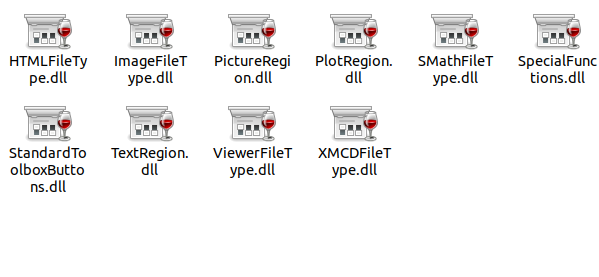

I solved problem with wine...
1. sudo apt-get install mono-complete
2. sudo apt-get install winetricks
3. winetricks dotnet45
4. copy smath installation from windows (whole directory) to linux (kubuntu)
5. wine /home/user_1/smath_99_7030_wine/SMathStudio_Desktop.exe
result - all symbols in side panel.

Thanks kamienna, I had SMath mono working in Linux Mint 19.3, but when upgraded my machine to Linux Mint 20, I was getting missing symbols in side panel.
I followed your instructions for using winetricks and just ignored all the error messages while the Windows .net dotnet45 was being installed.
Copied SMath from my Windows 10 machine and everything is now working again in LM20. All the symbols are displaying properly.

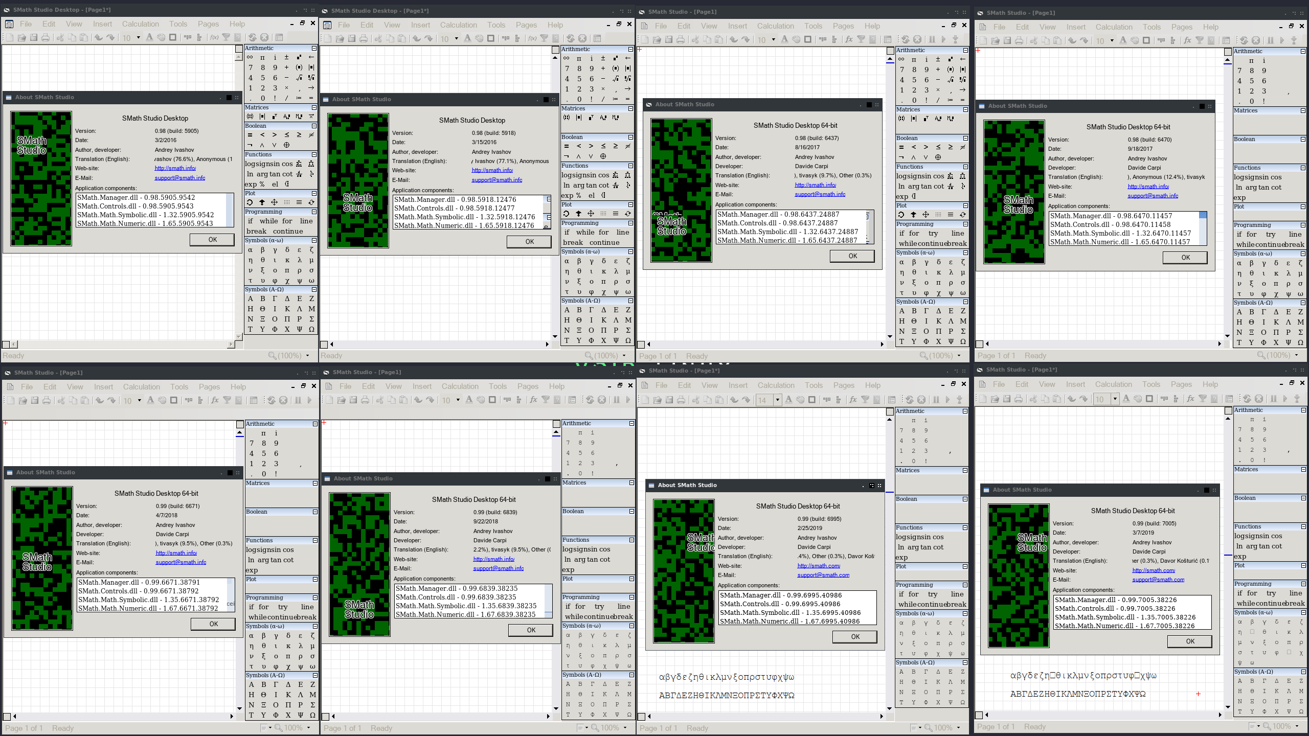

I have investigated the sidebar issue with previous builds.
Below I listed what happened to sidebar step by step on Linux Mono builds.
Sorry for the big picture but I had to prtscr that so everything can be seen in one screen.

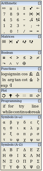

1- It was build 5905 when everything was fine.
2- When new functions added to matrices sidebar on build 5918, they didn't show up. But they are clickable.
3- Last working version beside new matrices functions was build 6437.
4- Starting from build 6470, a lot of sidebar buttons are missing. But sidebar button fonts are big on these builds.
5- Last big font but missing buttoned sidebar build was 6671.
6- On and after build 6839, buttons had slim fonts. This build had same amount of non-missing items as previous build and all alphabet items are shown.
7- The last full greek alphabet version was build 6995.
8- After build 7005, two alphabet buttons are missing too. These two additional they are not presented on previous builds.
You can not use them on SMath canvas either. They give only rectangle on regions not characters.
Andrey Ivashov 10/14/2020 1:56:00 AM

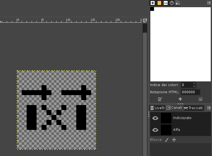

I think this is a key! Look at the vector multiplication icon: it is visible on 5905 and not visible on 5918. I have checked what was changed between these two revisions and found one related change only! I have changed an icon a bit, from File not found. to File not found.. Other icons is visible (instead of new vectorize button added in the same revision).
So it seems like I've started to use another tool to create images for the toolbars, but I do not remember any details now.
Here is an archive with both images directly from the sources: linux_image_button.7z (689 B) downloaded 858 time(s)., so maybe someone will find what is wrong in vectorumno-2477.gif against to vectorumno-321.gif (number here is a revision into repository). If we will understand it I will fix all the icons accordingly.
BTW: Today I am using PNG icon (vectorumno.png) instead of GIF, but we still have the issue on Linux... Actually all icons became invisible on 6470 because I've converted them to PNG format.
Peraphs if it's not something codec-related might be the size of the container wrt the size of the image (just an idea).
About these two images in particular seems they have different BG/transparent colors (white the old, black the new) and different color maps.
2020-10-14 14_27_05-[vectorumno-2477] (importata)-1.0 (Colore indicizzato interi a 8 bit gamma, GIMP.png
2020-10-14 14_26_45-[vectorumno-321] (importata)-4.0 (Colore indicizzato interi a 8 bit gamma, GIMP .png
Andrey Ivashov 10/14/2020 10:41:00 AM

Heh, taking in account that image has black pixels only and alpha color is also black... image must look fully transparent. So, nothing strange happens.
But how this could be? Why it is shown correctly on Windows then?
Please, could you check PNG image as well? Does it have the same colors?
the PNG file has 2 colors (black and transparent black), however PNG format has alpha channel while GIF has just transparency. Transparency on black color might be the problem in mono?
2020-10-14 15_37_01-[vectorumno] (importata)-1.0 (Colore indicizzato interi a 8 bit gamma, GIMP buil.png
we can try if these works better (32bit and 32bit deinterlaced made with paint.net)
