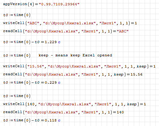

You can try this version. Just replace the ExcelIOCom.dll file.
ExcelIOCom.7109.zip (9,41 КиБ) скачан 406 раз(а).
EDIT. I added this plugin to the gallery. Previously, it was not there, because it is very old. Unfortunately, this plugin will not work in Linux, as based on COM.
I made a mistake in the type of plugin. Now I understood what was meant. I will try to update this plugin as well.
