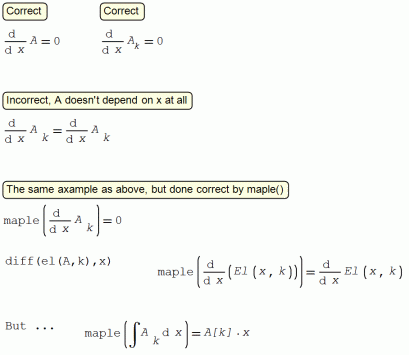

Please see attached example.

#3 Опубликовано: 07.10.2019 22:07:31
Hi Tom. maple() knows how to eval diff because, as plugin, Viacheslav (uni, plugin author) know how to handle the function el(A,k). But notice what happen with an unknoun function, like El(A,k). So, problem here is what to do with the SMath el(A,k) with the operator diff.

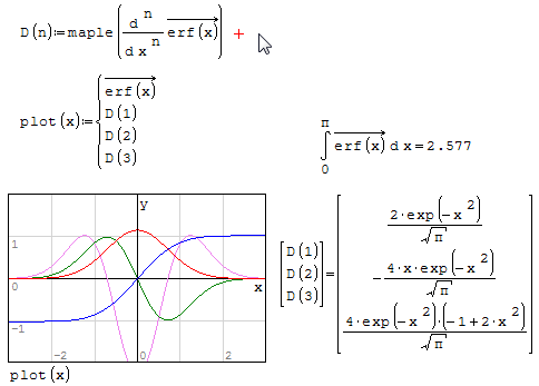

#4 Опубликовано: 08.10.2019 06:14:03
Get more from the companions ...
#5 Опубликовано: 08.10.2019 09:34:26
As you mentioned Ei(x), like many special functions,
you may have to rescue from infinitesimal analysis,
the ancestor of CAS.
sym_diff_issue (more).sm (12,37 КиБ) скачан 1284 раз(а).

I think this is a bug.
If there is no evidence that variable A[k] depends on x, dA[k]/dx should be immediately set to 0.
This is the way how symbolic engine of Wolfram Mathematica works.
Probably, I made a mistake mentioning "indexed functions", the right subject name should be "indexed symbolic variables" instead.
In real case A[k] were indexed unknowns in the system of equations.
I intentionally made this example as simple as possible to make it evident.
