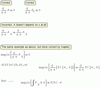

Please see attached example.

Hi Tom. maple() knows how to eval diff because, as plugin, Viacheslav (uni, plugin author) know how to handle the function el(A,k). But notice what happen with an unknoun function, like El(A,k). So, problem here is what to do with the SMath el(A,k) with the operator diff.

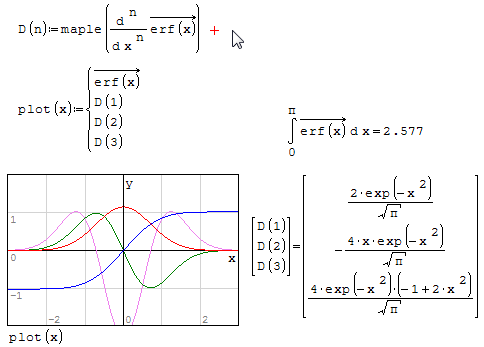

#4 Posted: 10/8/2019 6:14:03 AM
Get more from the companions ...

I think this is a bug.
If there is no evidence that variable A[k] depends on x, dA[k]/dx should be immediately set to 0.
This is the way how symbolic engine of Wolfram Mathematica works.
Probably, I made a mistake mentioning "indexed functions", the right subject name should be "indexed symbolic variables" instead.
In real case A[k] were indexed unknowns in the system of equations.
I intentionally made this example as simple as possible to make it evident.
