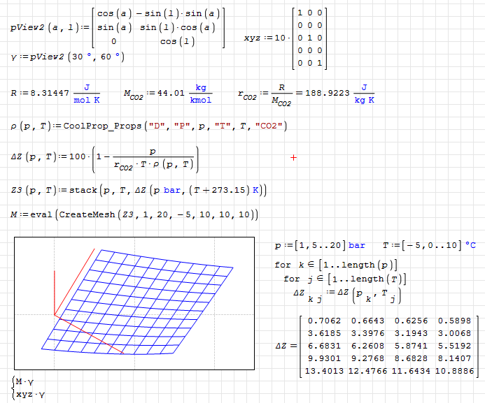

#2 Опубликовано: 14.12.2025 01:40:46
Hi. This is a way.
Z-CO2.sm (16,56 КиБ) скачан 881 раз(а).
Отредактировано 14.12.2025 05:15:11

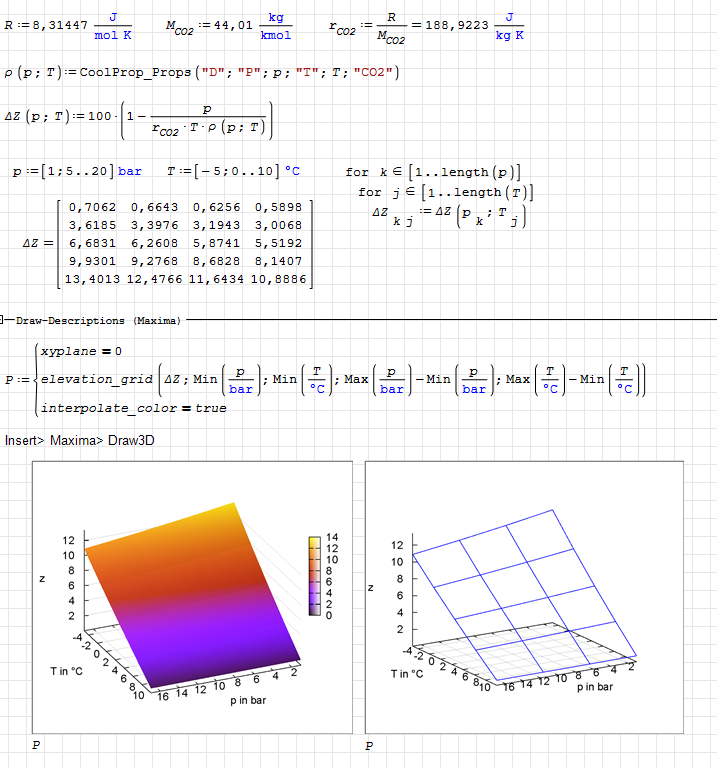

i would like to use char3D or Maxima plot. Is the procedure same?
#4 Опубликовано: 14.12.2025 12:32:34
Hi Tomas. I assume so. And also in maple, dislin, and others. But I'm not skilled enough in those methods to show you the most effective way to use them.

#6 Опубликовано: 17.12.2025 22:17:20
The plots can be rotated with the mouse, yet there is a considerable time lag.
3d.sm (219,19 КиБ) скачан 849 раз(а).
Отредактировано 17.12.2025 22:18:37
