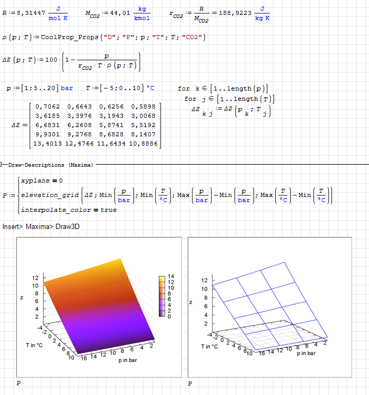

i would like to create 3d plot of compresibility with p and T as axis. How can i do that?

Hi. This is a way.
Z-CO2.sm (16.56 KiB) downloaded 881 time(s).
Edited 12/14/2025 5:15:11 AM

i would like to use char3D or Maxima plot. Is the procedure same?

Hi Tomas. I assume so. And also in maple, dislin, and others. But I'm not skilled enough in those methods to show you the most effective way to use them.

The plots can be rotated with the mouse, yet there is a considerable time lag.
3d.sm (219.19 KiB) downloaded 849 time(s).
