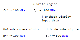

Hi. As Davide says, there are only some few characters for subscripting with Unicode chars. This is a workaround for this case and some others:
fc'.sm (4,71 КиБ) скачан 1174 раз(а).
