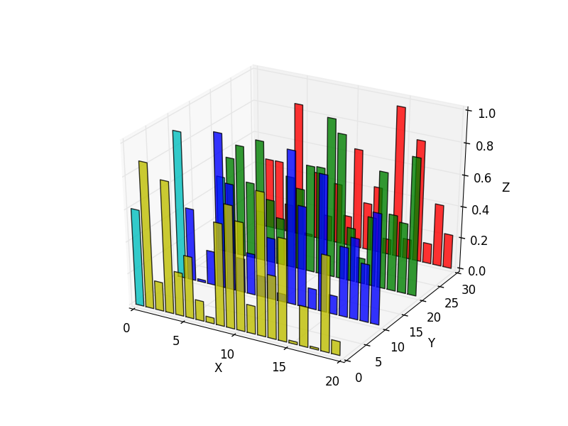

Unfortunately, there seems to be no easy access from c# to matplotlib. Otherwise that would be a really good alternative.
There is a way. Use a call to python as an external program. I can save image to a file and load it into SMath Studio (as for Maple Plot). But the end user must install Python itself and two libraries: mathplotlib and numpy. I've tried it, it basically works. This is the only way at the moment.
