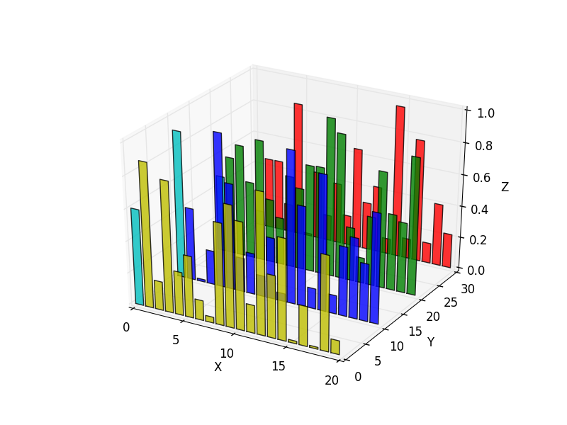

#9 Posted: 5/25/2013 6:15:32 AM
1,359 likes in 2,273 posts.
Uni, I am looking forward to see gnuplot being operated from within SMath, even be it just as in maplewrapper by editing text and getting image display.
maple may have more functions for plotting but could not generally be recommended due to license issues.
Unfortunately, there seems to be no easy access from c# to matplotlib. Otherwise that would be a really good alternative.
There is a way. Use a call to python as an external program. I can save image to a file and load it into SMath Studio (as for Maple Plot). But the end user must install Python itself and two libraries: mathplotlib and numpy. I've tried it, it basically works. This is the only way at the moment.
That looks good. Besides the mentioned install requirements there is perhaps no chance for interactive mouse control. Still better than maple, where there are license issues and the image quality is worse.
However, non-interactive graphics nowadays are suited for die-hard users and probably not accepted by normal users. Perhaps an option is to provide some sort of generic wrappers that provide comfortable access to basic plotting plus a scripting window.
Btw, how about Sympy? I don't now, if that outperforms mapleV, but it is free both as in beer and in speech.
