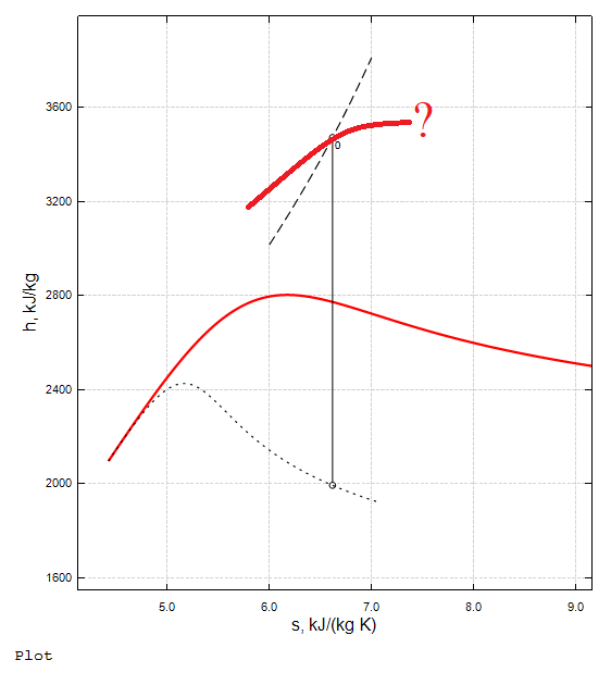

Hi. Comparing the result with the other water compound implementation.
h-s-diagram-Steam.sm (28,14 КиБ) скачан 1256 раз(а).

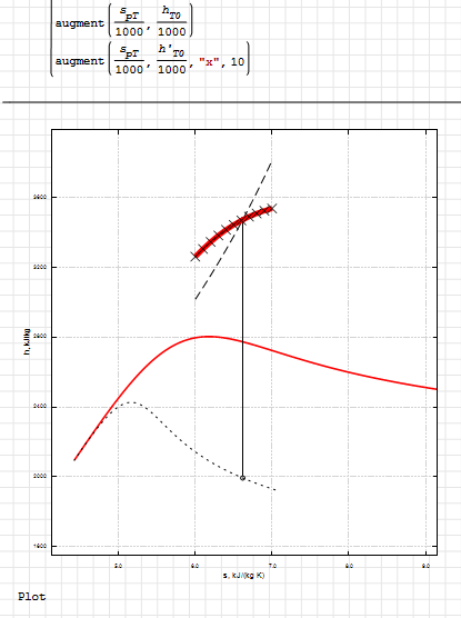

My solution. Now I'm thinking about isochore and second isotherm.
h-s-diagram-Steam.sm (31,02 КиБ) скачан 1321 раз(а).

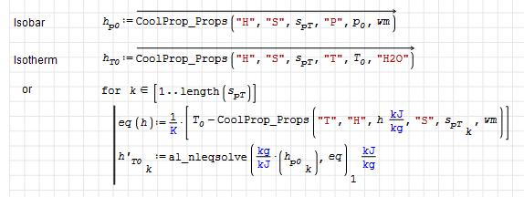

With Mathcad Prime and WaterSteamPro

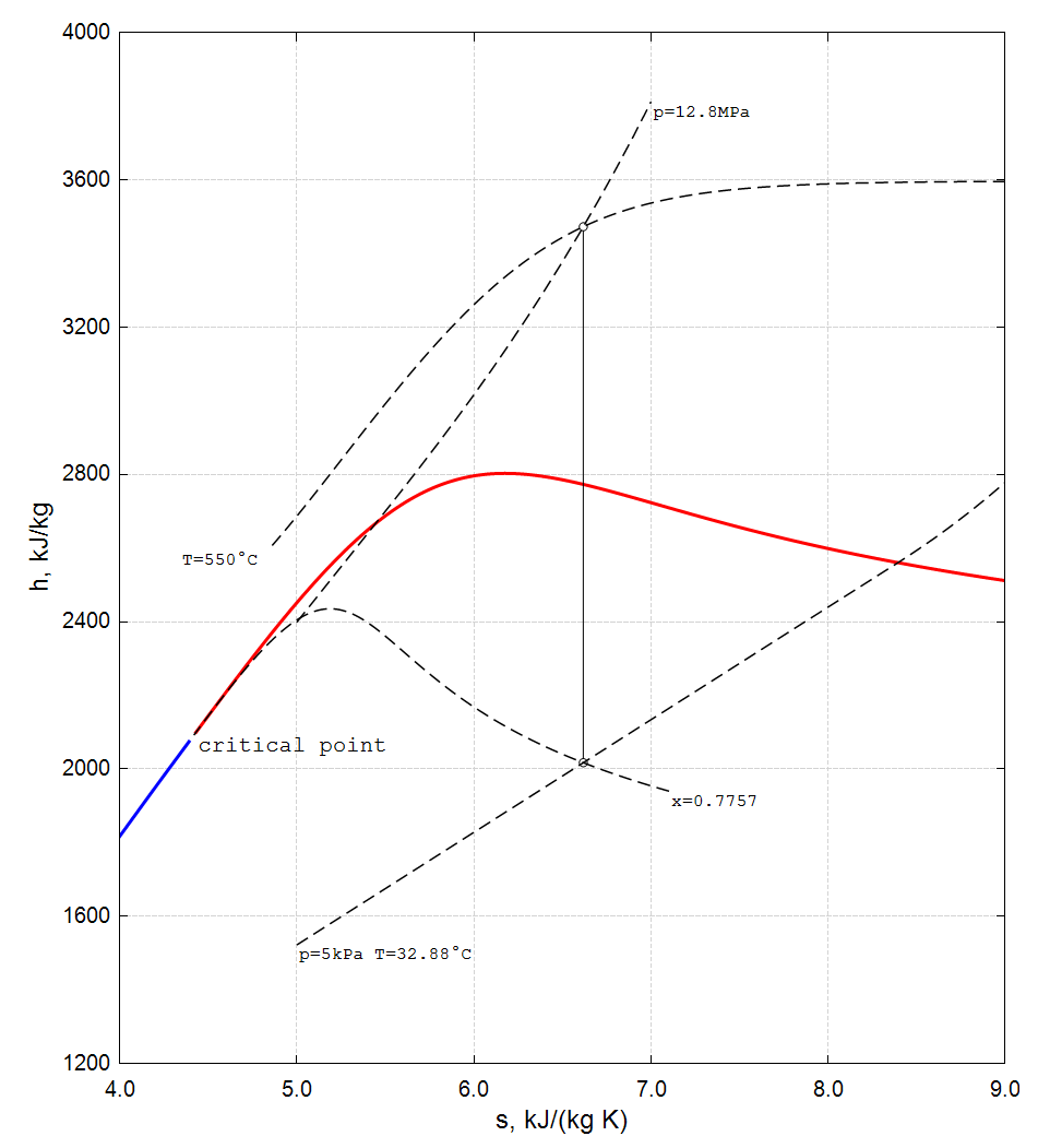

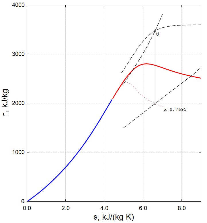

New version
h-s-diagram-Steam.sm (41,67 КиБ) скачан 1266 раз(а).
