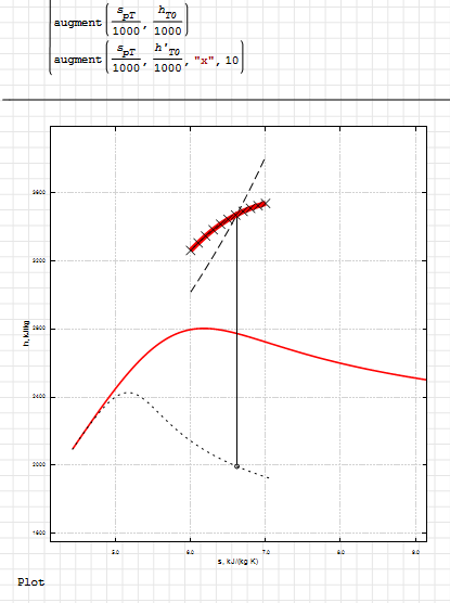

Hi. Comparing the result with the other water compound implementation.

My solution. Now I'm thinking about isochore and second isotherm.

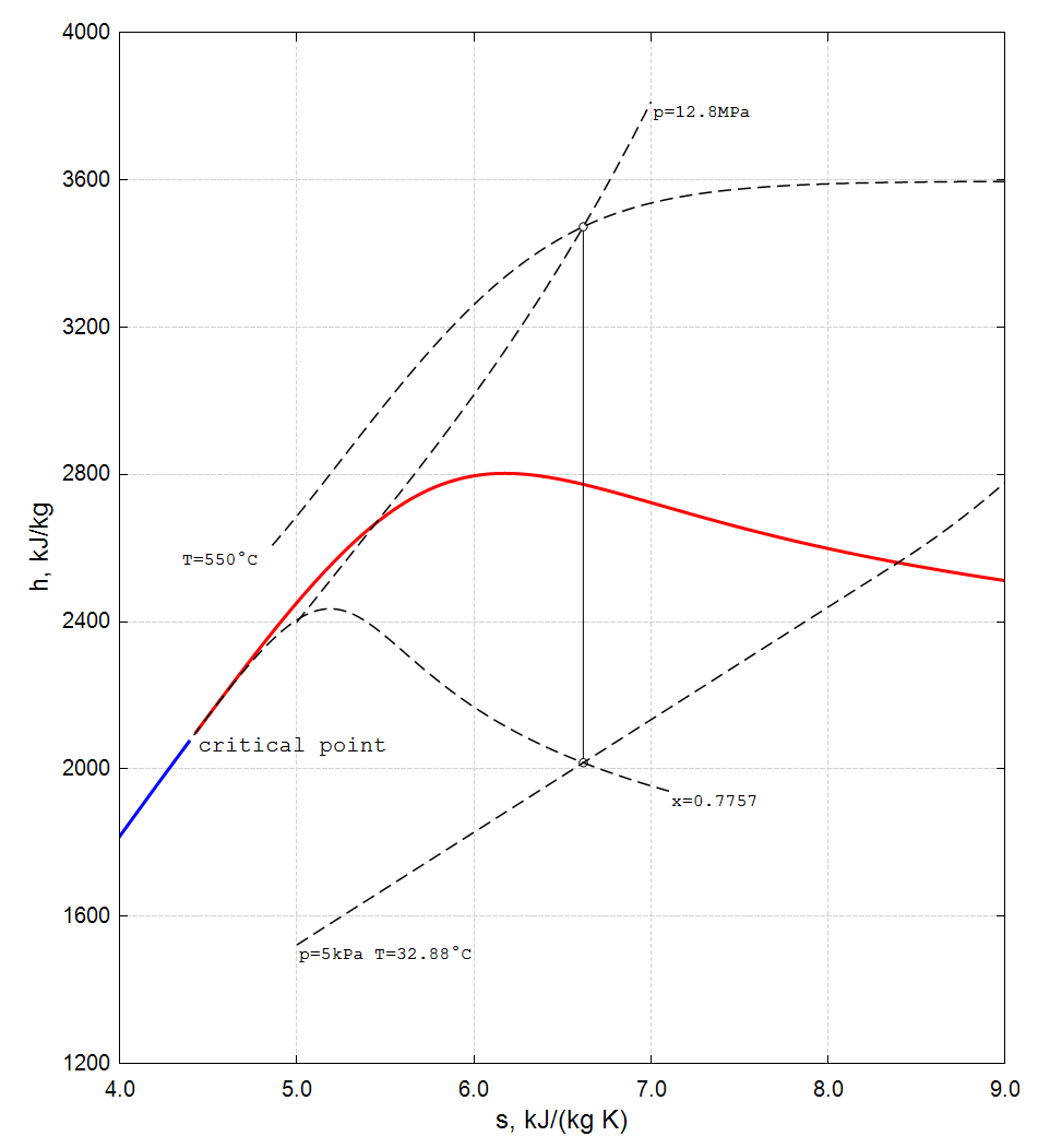

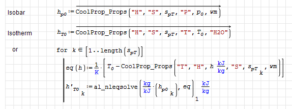

With Mathcad Prime and WaterSteamPro

New version
