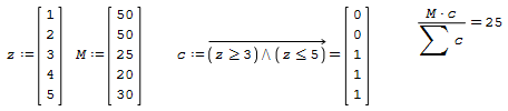

#2 Опубликовано: 28.12.2023 07:13:05
Worksheet7.sm (4,2 КиБ) скачан 1426 раз(а).
M*c / c*c would also do.

Aha, that should work.
Thanks!

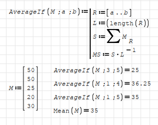

#4 Опубликовано: 28.12.2023 16:04:11
This is another way.
AverageIf.sm (5,16 КиБ) скачан 1465 раз(а).

Took me a couple of minutes to wrap my head around this one, but now it makes sense.
Thanks!!

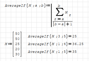

#6 Опубликовано: 29.12.2023 06:19:06
This maybe an easier way.
NDTM Amarasekera 29.12.2023 09:03:00
