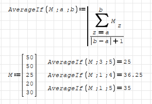

Hi all, there seems to be no function similar to the Excel function "AverageIf" in SMath. Let me set up a hypothetical example with two vectors:
z = [1 2 3 4 5]
M = [50 50 25 20 30]
Let's say that I want to calculate the average value of M for z => 3 AND z <=5. In this case, it should be (25+20+30)/3=25. What would be the best way to go about this? The "Mean" function in SMath returns the mean of the whole vector, so when I write a For loop with an If condition to extract values of M for the interval z, I don't know how to assign "blank" values to the cells that fall outside the defined range so it doesn't affect the average if it makes sense. What I then get is (0+0+25+20+30)/5=15
Thanks in advance as always!
#2 Posted: 12/28/2023 7:13:05 AM
1,355 likes in 2,271 posts.
Worksheet7.sm (4.2 KiB) downloaded 1369 time(s).
M*c / c*c would also do.

#3 Posted: 12/28/2023 11:58:26 AM
Fikret Atalay
Fikret Atalay
2 likes in 24 posts.
Aha, that should work.
Thanks!

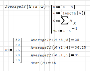

#4 Posted: 12/28/2023 4:04:11 PM
598 likes in 1,380 posts.
This is another way.
AverageIf.sm (5.16 KiB) downloaded 1421 time(s).

#5 Posted: 12/29/2023 5:55:40 AM
Fikret Atalay
Fikret Atalay
Took me a couple of minutes to wrap my head around this one, but now it makes sense.
Thanks!!
#6 Posted: 12/29/2023 6:19:06 AM
This maybe an easier way.
