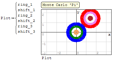

#16 Опубликовано: 28.02.2020 10:21:58
As interpreted ... ?
1. You can have as many rings as desired, sizes as well.
2. It may be profitable to transit/spool to file.
3. You may have in any Web colors from otherwise construction ?
4. Rectangle may be added ?
Circle Monte Carlo.sm (24,04 КиБ) скачан 1123 раз(а).
#17 Опубликовано: 28.02.2020 11:40:50
2 confirmations:
1. Spool to file YES for recovering from other document.
2. Web colors YES from code ... somewhat greedy !
Circle Monte Carlo.sm (32,22 КиБ) скачан 1143 раз(а).
#18 Опубликовано: 02.03.2020 17:43:34
... a much faster version.
Circle Monte Carlo.sm (33,97 КиБ) скачан 1134 раз(а).
