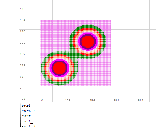

Much different stuff ... you can shift another set,
as well as plot in a random filled square.
Too long to resume in my laptop.
Circle Magic Disk.sm (27.28 KiB) downloaded 1183 time(s).

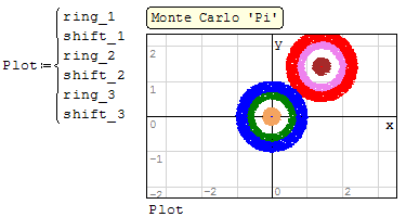

1. You can have as many rings as desired, sizes as well.
2. It may be profitable to transit/spool to file.
3. You may have in any Web colors from otherwise construction ?
4. Rectangle may be added ?
Circle Monte Carlo.sm (24.04 KiB) downloaded 1122 time(s).
#17 Posted: 2/28/2020 11:40:50 AM
2 confirmations:
1. Spool to file YES for recovering from other document.
2. Web colors YES from code ... somewhat greedy !
Circle Monte Carlo.sm (32.22 KiB) downloaded 1143 time(s).
#18 Posted: 3/2/2020 5:43:34 PM
... a much faster version.
Circle Monte Carlo.sm (33.97 KiB) downloaded 1133 time(s).
