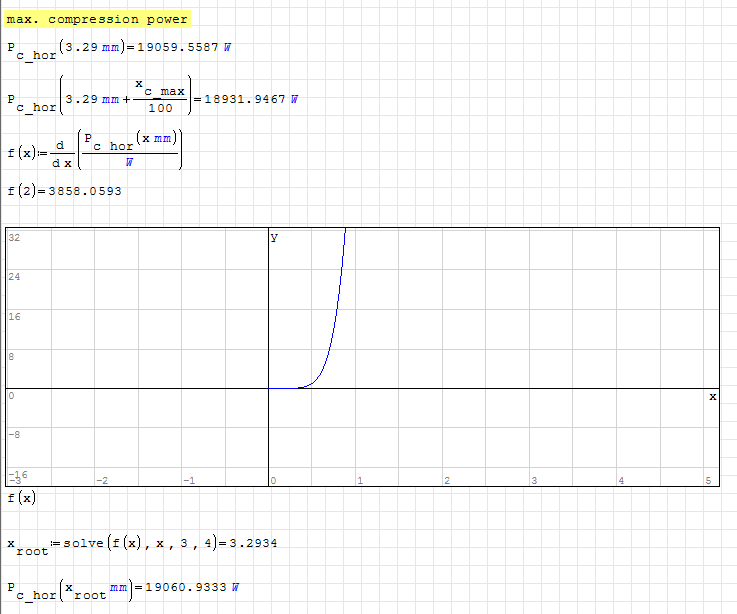

Dear all,
I am currently struggling with a basic function extreme problem
NOK.sm (15 КиБ) скачан 1232 раз(а).
OK.sm (60,92 КиБ) скачан 1180 раз(а).
edit by mod: names of attachments are swapped, as mentioned below
In the first screenshot, the function derivative definition results in a warning message: "input string was not in a correct format"
In the last screenshot, I removed all parameters values that aren't related to the given formulas (not visible in the screenshot), and I get the right solution?! However, I don't see the root visually in the accompanying graph?
I thought it had something to do with the reservation of parameter "x", but this doesn't seem to be the case...
Thanks in advance for any feedback!
Kind regards from Belgium,
Jan
The root(s) won't appear by magic ! You must instruct the plot.
Click left/right on the 2nd plot ... enable "Display input data"

Hello Jean,
What I meant was that the derivative graph doesn't cross the X-axis at x=3.29, this is where the original function P_c_hor(x) reaches it's maximum.
This is odd, since the root function indicates correctly a root at x=3.29 in the file NOK.sm (I switched the names the smath files, my mistake... ).
So my question remains: why does the solve function doesn't work in both attached files?

#10 Опубликовано: 16.08.2017 13:18:46
... as it looks, the derivative as given is not accepted.
The mouse had problem digesting the elephant .
Done from infinitesimal analysis ... OK.
Maybe I open the wrong sheet ?
OK repaired.sm (63,49 КиБ) скачан 1205 раз(а).

#12 Опубликовано: 17.08.2017 14:46:41
However, it stays unclear why my approach works in sheet "nok.sm" and not in "ok.sm", while it's 100% the same in both cases?!
There seems to be something wrong underneath the smath "boot"?
Can't explain either. NO unit plots much smaller in magnitude and the function q(x) ends @ 3.5.
Infinitesimal analysis is a Lagrangian method that existed before "Symbolic engines".
Was effective for Excel to manage more advanced maths before Mathcad/Mathsoft... Maple.
It applies to 2nd derivative as well and integral. The 2nd derivative
starts producing noise [world is not perfect]. The Lagrangian methods extend
to point derivatives/integral ... very useful for point capture systems like
in Process Control & Instrumentation where have only values [accumulated values].
In the red, in the attached, I have isolated the Guilty ... Ah !
As it looks, with the unit system those "Guilty" may be smaller, thus less guilty.
Cheers, Jean
OK repaired.sm (144,28 КиБ) скачан 1234 раз(а).
