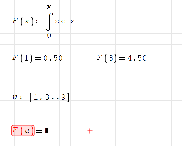

How to get integration value in range
How to get integration value in range - Сообщения
#1 Опубликовано: 30.01.2021 11:19:03
netsonicyxf
netsonicyxf
2 сообщений из 79 понравились пользователям.
Smath
MathCAD Prime

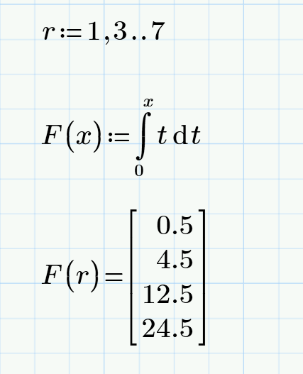

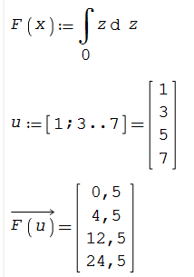

#2 Опубликовано: 30.01.2021 11:41:19
in Smath you have to use explicit vectorization

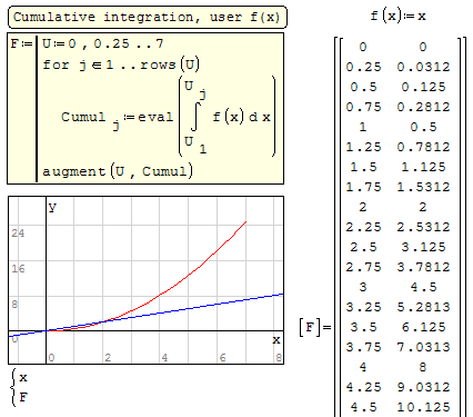

#5 Опубликовано: 30.01.2021 23:09:00

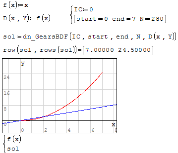

... hyperfast.

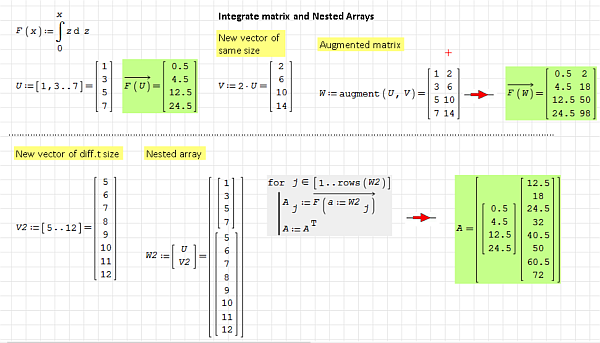

NDTM Amarasekera
NDTM Amarasekera
Integration values extended to matrix and nested arrays.
