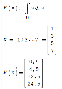

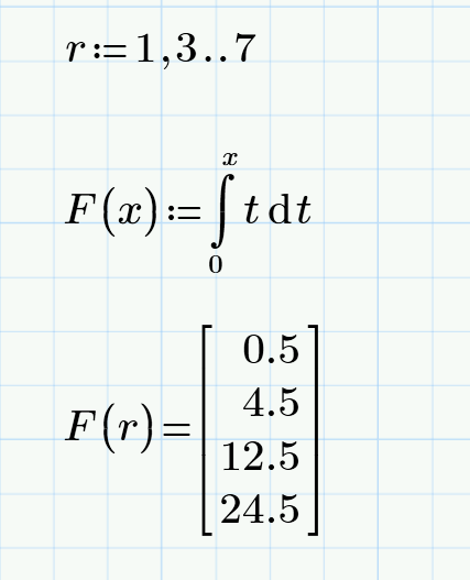

in Smath you have to use explicit vectorization

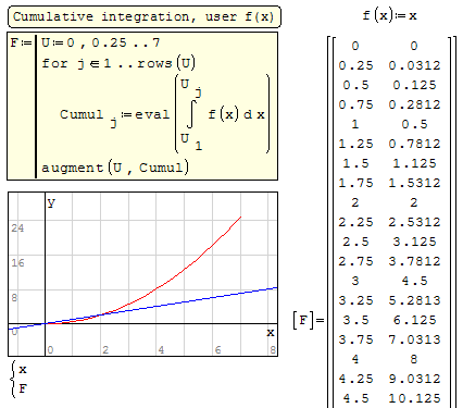

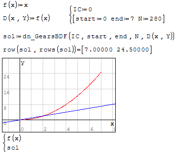

#5 Posted: 1/30/2021 11:09:00 PM
... hyperfast.

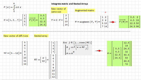

#6 Posted: 1/31/2021 3:09:04 AM
NDTM Amarasekera
NDTM Amarasekera
130 likes in 352 posts.
Integration values extended to matrix and nested arrays.
