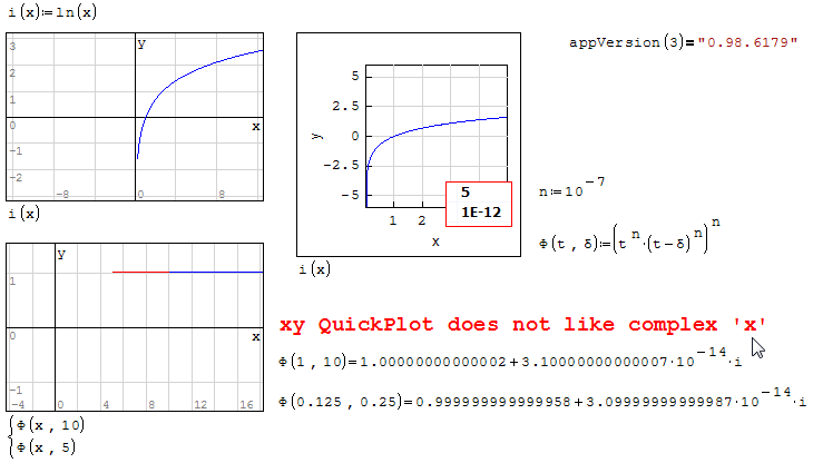

#6 Опубликовано: 04.10.2018 21:44:46
When I try to type i(t) I get i*(t), automaticaly. Why?
Basile,
Can you plot or not ? That is the question.
If NOT: a damned bug or missing link.
Certainly not a feature. That 'i' imaginary freaks an indexed
for loop still exists in 6179 ... index 'ii' or else.

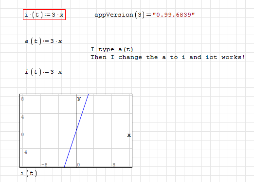

Hello to All,
This is my solution:
Basile
