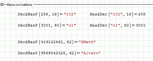

Hi. I use this.
numbase.sm (12,8 КиБ) скачан 1894 раз(а).

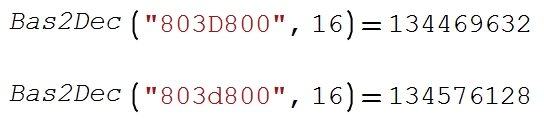

This is cool, but Bas2Dec("803d800",16)=134576128 - is no true. True resulit is 134469632. Help me pleas.
#12 Опубликовано: 17.03.2020 02:07:15
1 132 сообщений из 1 801 понравились пользователям.
Hi. Sorry for the long delay.
I don't use ucase function, so those are different strings:
