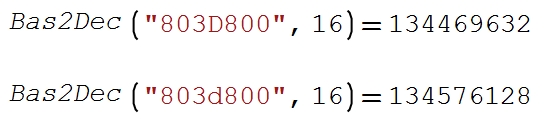

This is cool, but Bas2Dec("803d800",16)=134576128 - is no true. True resulit is 134469632. Help me pleas.
