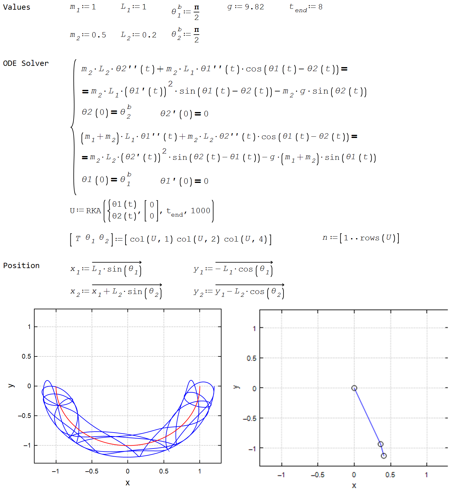

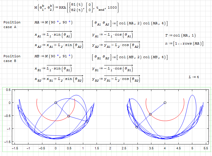

I feel the model is not correct - help please!
Pendulum-2-animation.sm (22,59 КиБ) скачан 70 раз(а).
Отредактировано 20.09.2026 10:09:28

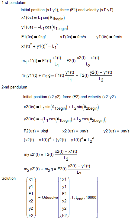

Hi Valery. The system is coupled. This is a way to solve it.
double_pendulum_lagrangian.sm (122,44 КиБ) скачан 60 раз(а).
double_pendulum_lagrangian.pdf (637,78 КиБ) скачан 31 раз(а).

If mathematics is a tautology, then life must be one too. That joke reminds me of the one a plant process engineer played on me when I went to get the bourdon gauge I was supposed to install. Without a word, he handed me a brown box. That was when I have the bad idea of asking what was inside. His answer was that it contained a mechanical device that measures fluid pressure using a curved, flattened metal tube that straightens as internal pressure increases, driving an indicator needle across a calibrated dial.

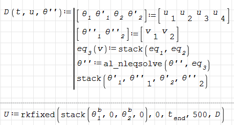

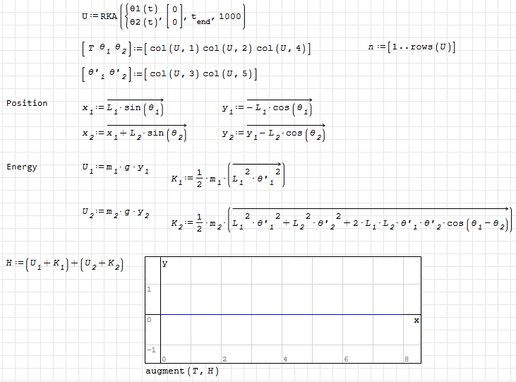

The RKA function includes the necessary procedures to solve hard coupled systems.
double_pendulum_RKA.pdf (483,53 КиБ) скачан 25 раз(а).
double_pendulum_RKA.sm (43,57 КиБ) скачан 54 раз(а).
