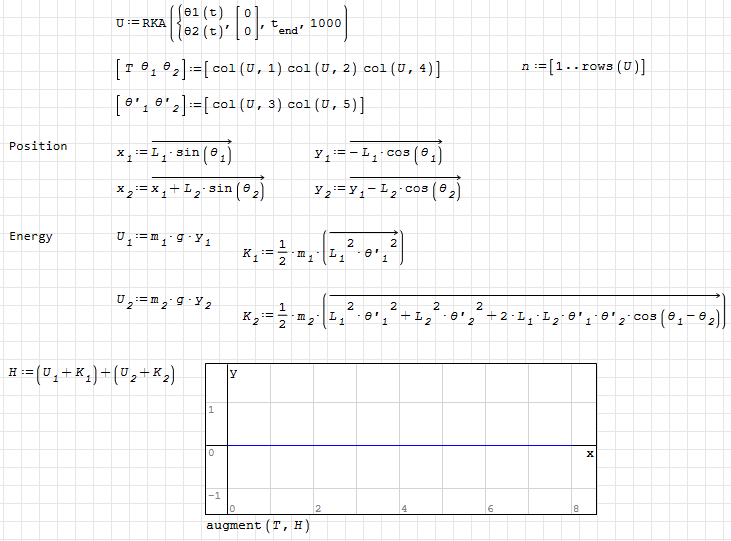

Sum of energies for the verify the model and ODEs solver. Must be const.
Help please!

Hi Valery. This is a way. You can plot the time in T versus U, K or U+K. The plot in the figure shows that the energy is constant. In this case also, the total energy is the hamiltonian.

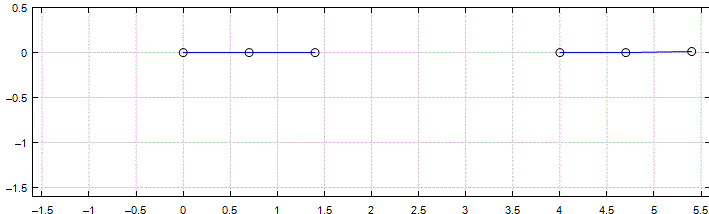

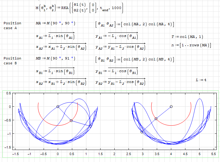

I propose you a problem, dealing with the Butterfly Effect on a double pendulum - after some cycles, the 2 pendulums becoms distinct. Attached there is a simple gif file
#9 Опубликовано: 10.10.2026 00:03:48
Hi Ioan. Something like this.
double_pendulum_RKA Butterfly Effect.sm (50,58 КиБ) скачан 161 раз(а).

Ooo it's wonderful!!!
My dumb explanation is that time delay generate between the 2 instances generate different precision in the solution graphics and hence the graphical difference (?).
