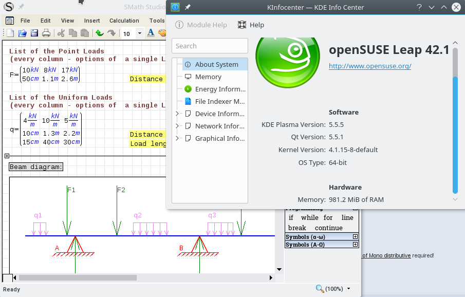

Cannot reproduce.
Just tested latest SMath Studio 0.98 (RC4) with latest Mono on fresh openSUSE. Everything works fine (complex worksheets, different plug-ins, etc.)
