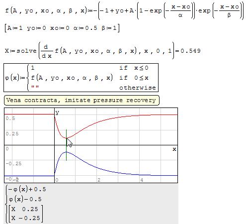

WroteI'm doing internships with students where they measuring for example for different flow the losses in a system.
... few more stuff for your Classroom Internships.
The orifice Plate [ISO-5167] is the standard I have use since Windows.
Previous to Windows, used Sharp pocket calculator iterative method.
Previous to calculating machinery: used the Foxboro booklet and log tables.
One way or another, Iso-5167 implements the 1970 Foxboro.
Orifice plate is an Engineering document.
Inst_Colebrook MOODY.sm (19,13 КиБ) скачан 1198 раз(а).
Inst_Orifice Plate.sm (387,98 КиБ) скачан 1277 раз(а).
Inst_Flow Profile.sm (673,87 КиБ) скачан 1317 раз(а).
