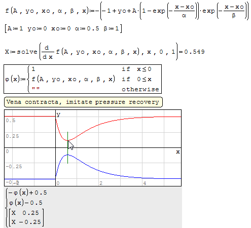

The orifice Plate [ISO-5167] is the standard I have use since Windows.
Previous to Windows, used Sharp pocket calculator iterative method.
Previous to calculating machinery: used the Foxboro booklet and log tables.
One way or another, Iso-5167 implements the 1970 Foxboro.
Orifice plate is an Engineering document.
Inst_Colebrook MOODY.sm (19.13 KiB) downloaded 1198 time(s).
Inst_Orifice Plate.sm (387.98 KiB) downloaded 1277 time(s).
Inst_Flow Profile.sm (673.87 KiB) downloaded 1317 time(s).
