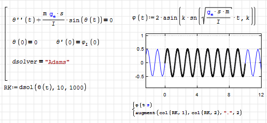

Hello all,
Again I recur to the Question Forums to attempt to solve an issue that I, single handely, cannot fix.
The issue I'm attempting to solve revolves around the definition of the movement of a certain bell, and the Horizontal forces produced by such movement.
In the attempt of solving this issue, I recurred to "Cephes Mathematical Library" Plugin, due to the necessity of implementing Jacobian Elipting Functions, as they are vital to obtain a more accturate discription of reality.
The problem I'm encountering is that the graph I create does not show anything at all, no matter how much I increase the frame window, or force parameters in the functions and equations I utilize.
I know this is quite the niche problem, but, if anyone has encountered similar problems as I have, I would be happy to hear solutions or steps to one.
I'll annex the SMath file for further investigation if necessary.
Much appreciated.

#2 Опубликовано: 26.02.2025 20:24:08
StvMath
StvMath
44 сообщений из 76 понравились и 1 не понравились пользователям.
The problem lies with the sine function. Your argument to the sine function has units. It needs to be unitless.

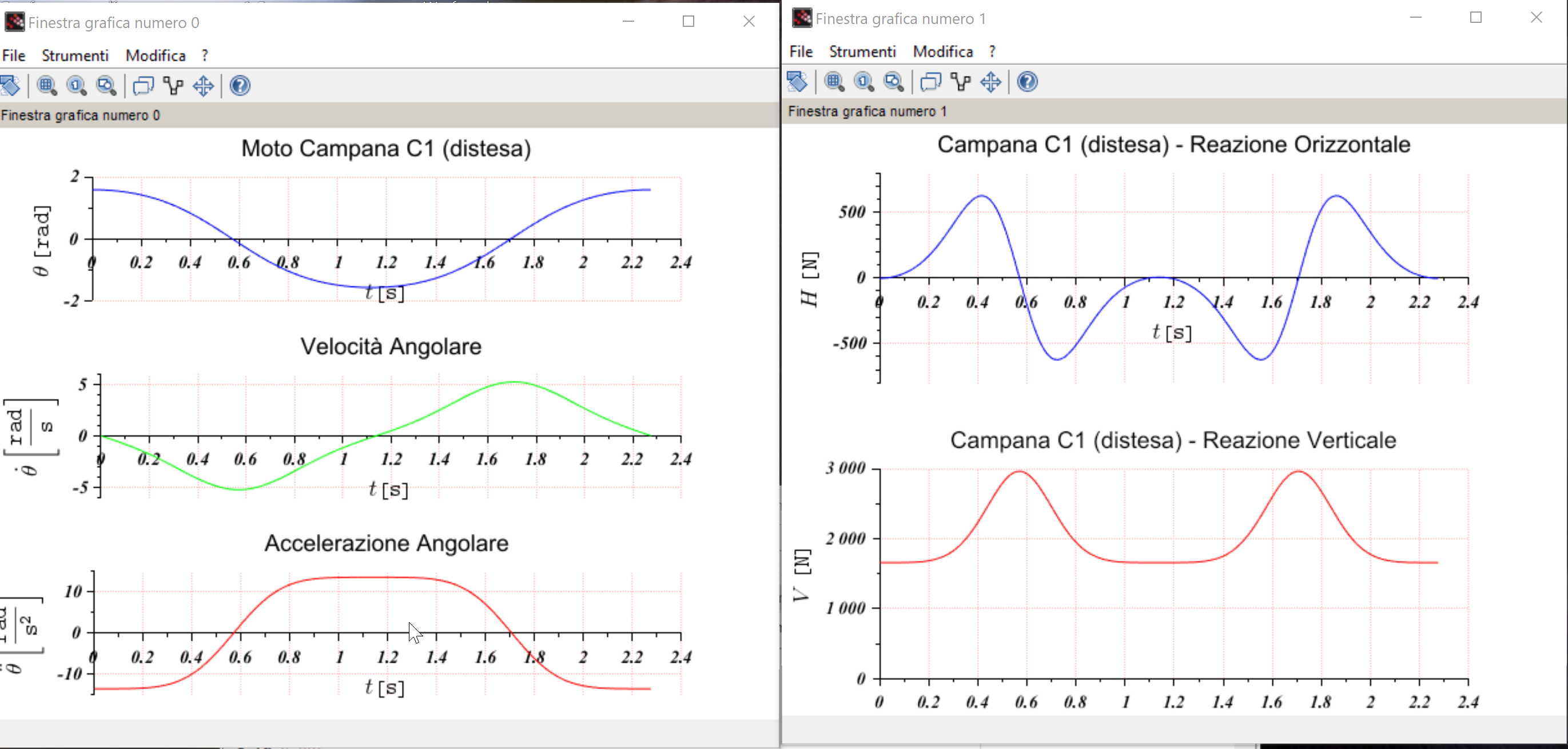

A long time ago I addressed the problem by writing this scilab script that I am attaching, omitting only the part for the production of the graphs. It also works to date. Maybe it can be useful to you, at the moment I don't have time to try to transform it into something Smath

#11 Опубликовано: 02.03.2025 07:38:48
A long time ago I addressed the problem by writing this scilab script ...
Hi Sergio. A solution, I guess that it is the same.
Campana di Pompelmo.pdf (524,95 КиБ) скачан 1018 раз(а).
Campana di Pompelmo.sm (1,01 МиБ) скачан 1815 раз(а).

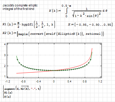

Alvaro, first of all thanks for the great job. I found an important mistake (partly caused by my lightness in the use of the "K" variable). %K is a Scilab function for the calculation of the Jacobi's complete elliptic integral of the first kind (I hope Smath has this function available)

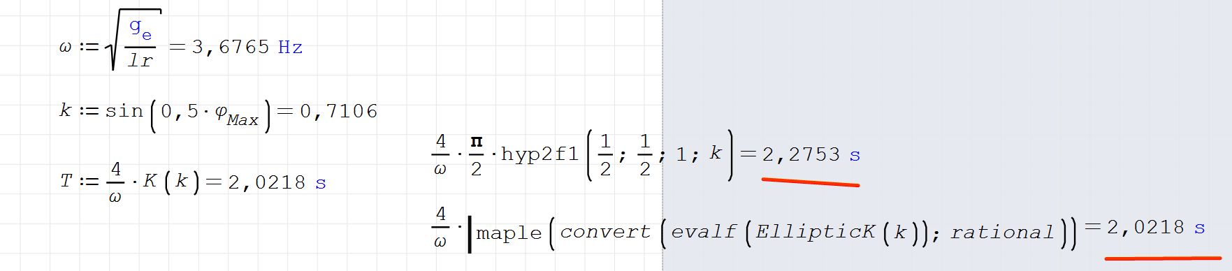

#15 Опубликовано: 03.03.2025 02:53:07
Alvaro thanks again.
Only a annotation for the calculation of the "K" function: you gave two methods (indicating what you think preferable); The other method numerically provides the same value provided by Scilab and in fact two rather different periods of oscillation are obtained as indicated below (2.02 s against 2.27 s).
I have no mathematical knowledge so high to be able to evaluate this difference that does not seem to me to be of an exclusively numerical type.

#16 Опубликовано: 03.03.2025 04:24:39
Hi Sergio. You're right. I couldn't find the function among the plugins, so I looked for equivalent ways of writing it on the Wolfram functions site. However, numerical problems with a 4-variable function can be really serious. Surely there is some other, more accurate way, and one that doesn't involve using Maple just to evaluate a function, no matter how special it is.
https://functions.wolfram.com/EllipticIntegrals/EllipticK/26/01/01/
Edited: With this version of K it seems to work fine
Campana di Pompelmo v3.sm (1,02 МиБ) скачан 1818 раз(а).
