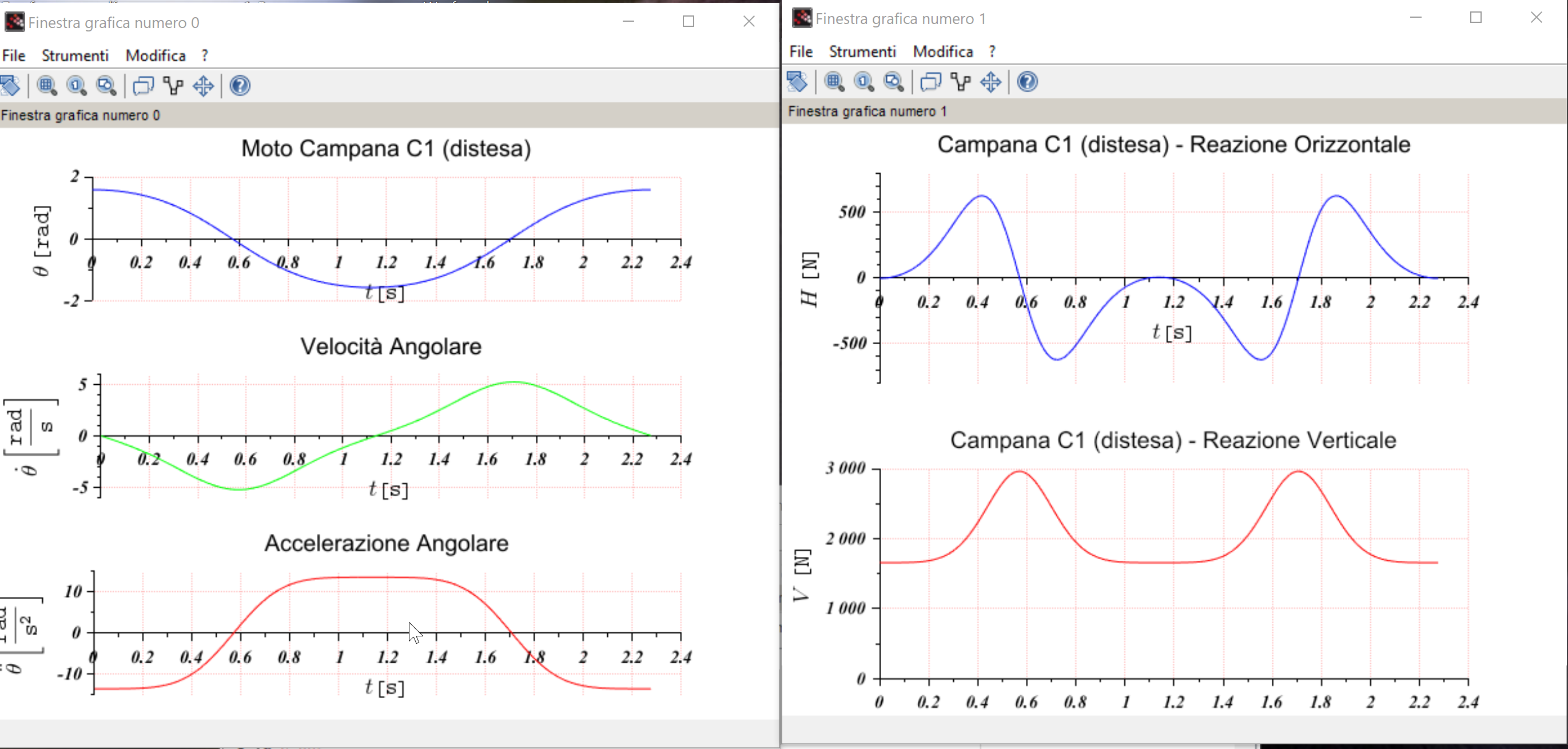

A long time ago I addressed the problem by writing this scilab script that I am attaching, omitting only the part for the production of the graphs. It also works to date. Maybe it can be useful to you, at the moment I don't have time to try to transform it into something Smath

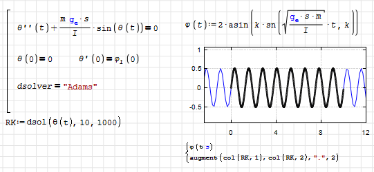

Hi Sergio. A solution, I guess that it is the same.
Campana di Pompelmo.pdf (524.95 KiB) downloaded 1018 time(s).
Campana di Pompelmo.sm (1.01 MiB) downloaded 1815 time(s).

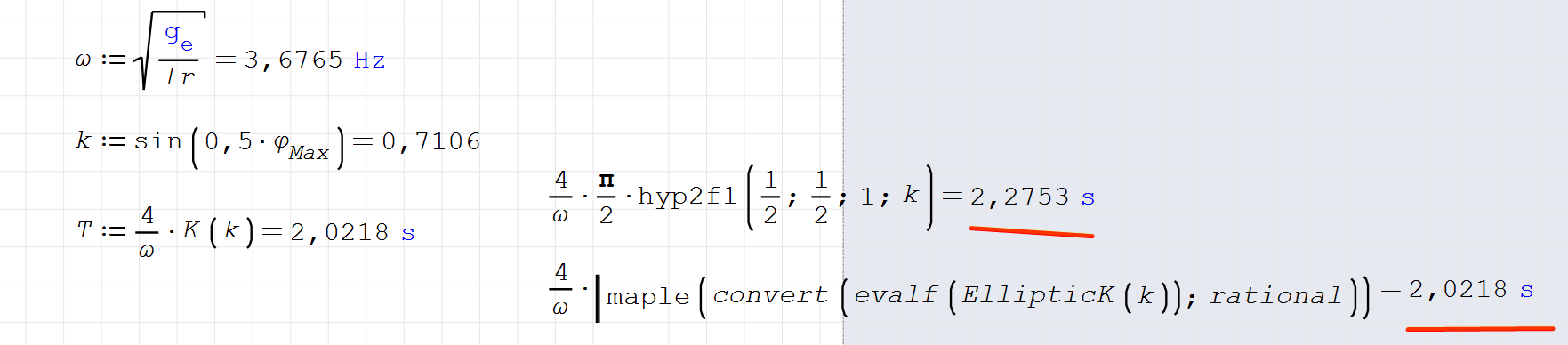

Only a annotation for the calculation of the "K" function: you gave two methods (indicating what you think preferable); The other method numerically provides the same value provided by Scilab and in fact two rather different periods of oscillation are obtained as indicated below (2.02 s against 2.27 s).
I have no mathematical knowledge so high to be able to evaluate this difference that does not seem to me to be of an exclusively numerical type.

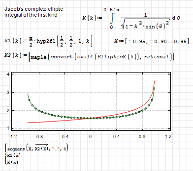

Hi Sergio. You're right. I couldn't find the function among the plugins, so I looked for equivalent ways of writing it on the Wolfram functions site. However, numerical problems with a 4-variable function can be really serious. Surely there is some other, more accurate way, and one that doesn't involve using Maple just to evaluate a function, no matter how special it is.
https://functions.wolfram.com/EllipticIntegrals/EllipticK/26/01/01/
Edited: With this version of K it seems to work fine
Campana di Pompelmo v3.sm (1.02 MiB) downloaded 1818 time(s).
