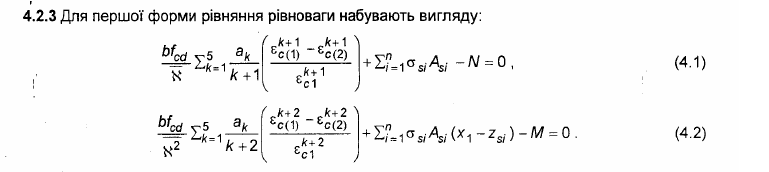

I have one formula where it is necessary to make a sum in a way that takes into account 5 coefficients of a polynomial. In the sum he is marked as ak and I need that instead of ak there was a1..a2..a3 ... a4 ... a5. Also, for each polynomial account, the power K automatically changes from the index of the polynomial 1..2..3..4..5. How to implement it in this program? Also, I have several layers of reinforcement in the equation that should also be instead of Asi to As1...As2...As3...Asn and Sigma_si to Sigma_s1...Sigma_s2...Sigma_s3...Sigma_sn . Sorry for bad English.

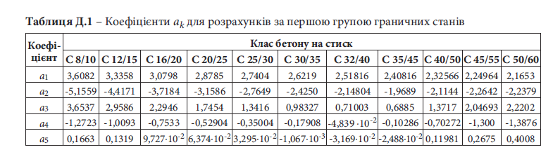

You have 11 sets of 'a'
Easy to tabulate, is it what you want ?

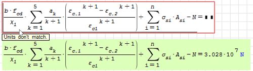

Unable to select individual components of the erroneous formula.
Arkush1_ndtma.sm (16,76 КиБ) скачан 1183 раз(а).
Arkush1_CBG [data].sm (136,18 КиБ) скачан 995 раз(а).

Pl look at this. Error may have occurred when entering the formula???? Difficult to trace.
There it seems the formula is ill posed wrt [4.1].
It shows bfcd as something not defined but the originator
has defined b, and defined fcd ... b*fcd.
