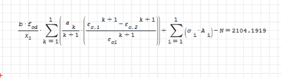

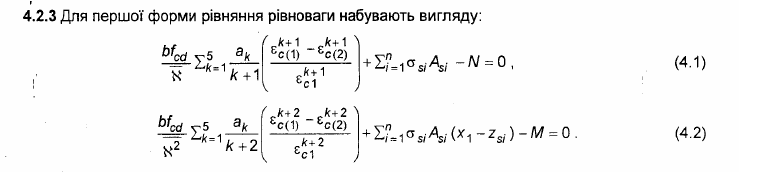

I have one formula where it is necessary to make a sum in a way that takes into account 5 coefficients of a polynomial. In the sum he is marked as ak and I need that instead of ak there was a1..a2..a3 ... a4 ... a5. Also, for each polynomial account, the power K automatically changes from the index of the polynomial 1..2..3..4..5. How to implement it in this program? Also, I have several layers of reinforcement in the equation that should also be instead of Asi to As1...As2...As3...Asn and Sigma_si to Sigma_s1...Sigma_s2...Sigma_s3...Sigma_sn . Sorry for bad English.

You made the following error: you used "a.k" instead of "a[k". This way you did not create vectors to use in the summation with the counter. You need to do to define and then use As and Sigmas.

I corrected a.k for a[k but how do I set 5 values for one variable a[k?

for example a[1:=2.5 a[2:=3.21 a[3:=-7.1
so "a" is a vector
in the sum a[k

Unable to determine the value of an element since the item with the specified index does not exist -error

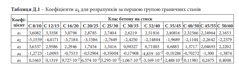

#9 Posted: 5/18/2018 1:18:18 PM
... you may clean/recast a bit.
You have 11 sets of 'a'
Easy to tabulate, is it what you want ?

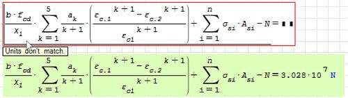

Arkush1_ndtma.sm (16.76 KiB) downloaded 1223 time(s).
#11 Posted: 5/18/2018 2:53:49 PM
Arkush1_CBG [data].sm (136.18 KiB) downloaded 1024 time(s).
#12 Posted: 5/18/2018 9:34:10 PM
Pl look at this. Error may have occurred when entering the formula???? Difficult to trace.
Unable to select individual components of the erroneous formula.
There it seems the formula is ill posed wrt [4.1].
It shows bfcd as something not defined but the originator
has defined b, and defined fcd ... b*fcd.
