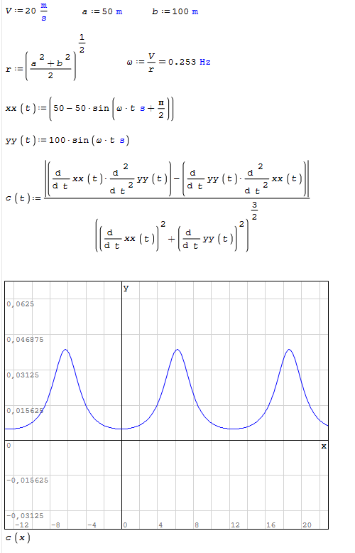

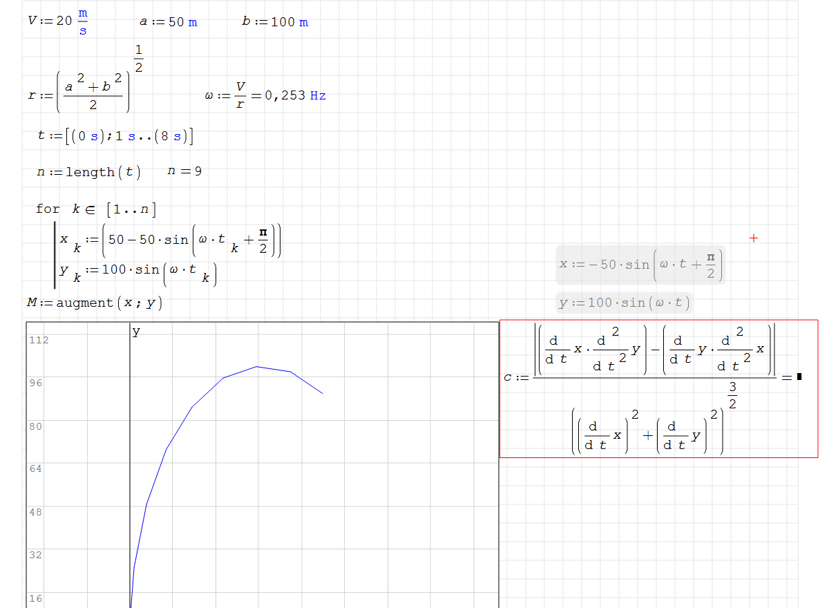

I have difficulty plotting the function c which depends on the derivatives of two functions which in turn depend on the parameter t.
Could anyone help me? This in the smath file.. curvatura.sm (11,36 КиБ) скачан 1592 раз(а).

Hello everyone!
I have difficulty plotting the function c which depends on the derivatives of two functions which in turn depend on the parameter t...
Maybe this is what you want...
... and the .sm file: curvatura1.sm (9,4 КиБ) скачан 1649 раз(а).

Could anyone help me ?
To plot both systems ... Jean
curvatura.sm (11,63 КиБ) скачан 1753 раз(а).
Maths Tangent.sm (91,95 КиБ) скачан 1648 раз(а).

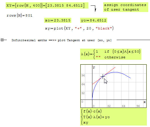

How can I draw the tangent line to the equation in parametric form?
this is the file … curvatura2.sm (12,5 КиБ) скачан 1680 раз(а).

Hi Ale. Here, some ways.
curvatura3.sm (25,1 КиБ) скачан 1644 раз(а).
curvatura4.sm (20,83 КиБ) скачан 1636 раз(а).

#8 Опубликовано: 06.12.2019 13:08:58
Thank you very much for the availability.
But I need more help.
For the Tangent over C(t), it will follow the scalar rules
of the document Tangent.sm posted before.
The Tangent over the parabola is another business.
Smath does not derive linterp(x) as it is NOT a function
only an interpolation. This project and lot more are
rescued via Infinitesimal Analysis [dates back before CAS].
For that particular typical user point of tangency, OK.
You may want to experiment more .
Don't mind to see noisy curvature [disabled in collapsed].
Chers ... Jean.
curvatura2 Copy.sm (30,56 КиБ) скачан 1627 раз(а).

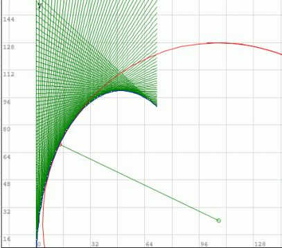

But if I wanted to find the tangent to the curve when the parameter t changes, how should I do?
#10 Опубликовано: 06.12.2019 14:05:01
Thanks for the answers.
Do you mean the envelope, all the tangents for the range en T?
curvatura5 - envelope.sm (23,64 КиБ) скачан 1522 раз(а).

#13 Опубликовано: 06.12.2019 22:48:04
Your project has been refactored strictly on discrete.
OK, you have functions but life is from collected data.
Collected data are always noisy from the quantization,
a small amount of Gaussian Ksmooth is often sufficient.
Ksmooth being applied before cinterp
As exemplified, cinterp is the best interpolator for
a clean curvature plot from infinitesimal maths.
I don't understand what your were attempting c(t) last module.
Please, don't hesitate for more.
Maths Tangent Data Set Copy.sm (36,61 КиБ) скачан 1608 раз(а).
