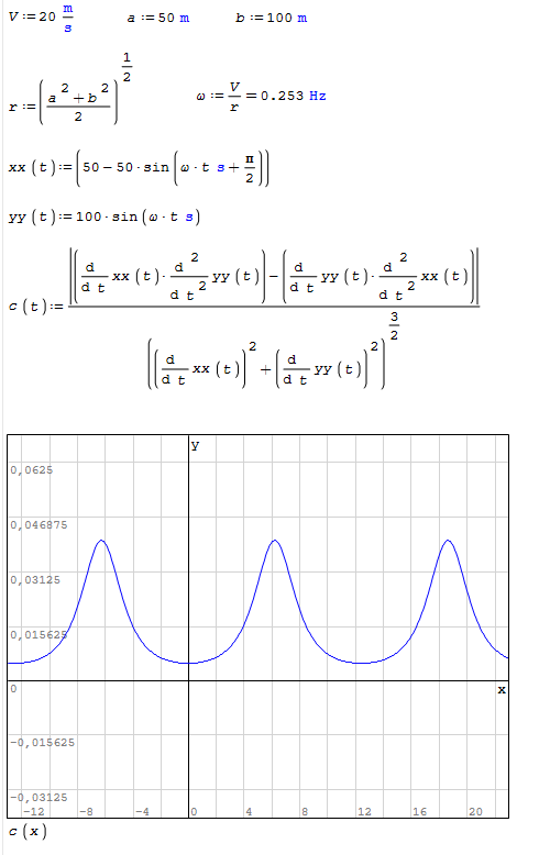

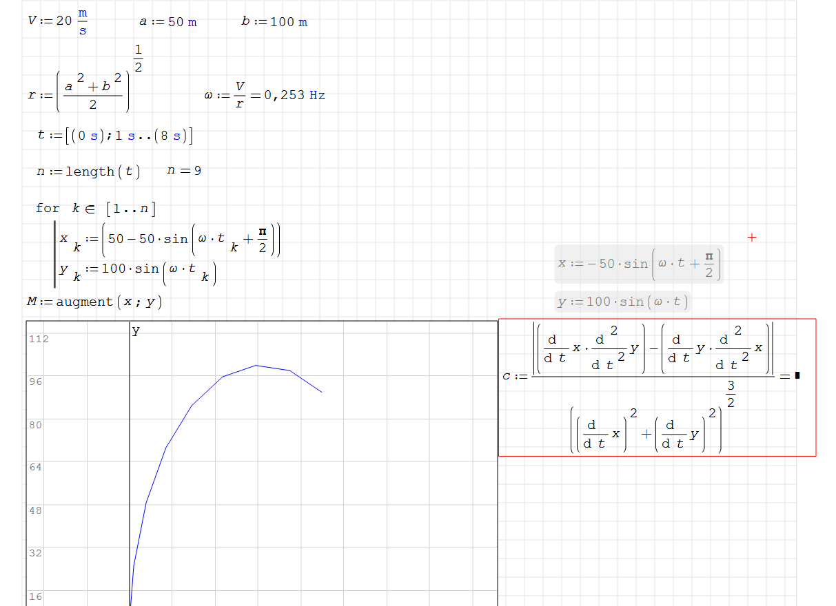

I have difficulty plotting the function c which depends on the derivatives of two functions which in turn depend on the parameter t.
Could anyone help me? This in the smath file.. curvatura.sm (11.36 KiB) downloaded 1628 time(s).
Thank you so much

I have difficulty plotting the function c which depends on the derivatives of two functions which in turn depend on the parameter t...
Maybe this is what you want...
... and the .sm file: curvatura1.sm (9.4 KiB) downloaded 1680 time(s).
#3 Posted: 12/4/2019 6:19:46 PM
Could anyone help me ?
To plot both systems ... Jean
curvatura.sm (11.63 KiB) downloaded 1793 time(s).
Maths Tangent.sm (91.95 KiB) downloaded 1687 time(s).

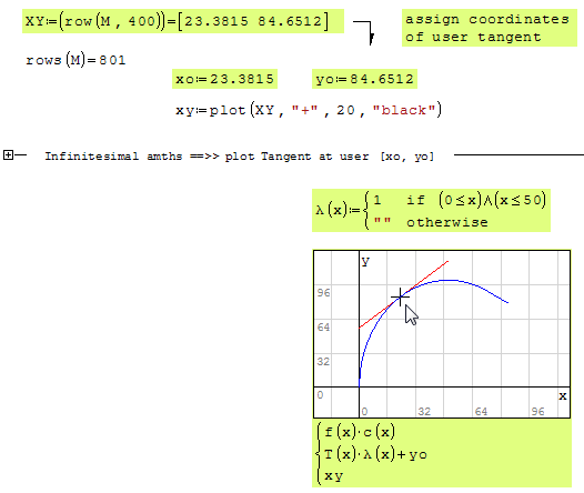

How can I draw the tangent line to the equation in parametric form?
this is the file … curvatura2.sm (12.5 KiB) downloaded 1721 time(s).
#7 Posted: 12/6/2019 12:48:15 PM
1,139 likes in 1,805 posts.
Hi Ale. Here, some ways.
curvatura3.sm (25.1 KiB) downloaded 1682 time(s).
curvatura4.sm (20.83 KiB) downloaded 1671 time(s).

#8 Posted: 12/6/2019 1:08:58 PM
Thank you very much for the availability.
But I need more help.
For the Tangent over C(t), it will follow the scalar rules
of the document Tangent.sm posted before.
The Tangent over the parabola is another business.
Smath does not derive linterp(x) as it is NOT a function
only an interpolation. This project and lot more are
rescued via Infinitesimal Analysis [dates back before CAS].
For that particular typical user point of tangency, OK.
You may want to experiment more .
Don't mind to see noisy curvature [disabled in collapsed].
Chers ... Jean.
curvatura2 Copy.sm (30.56 KiB) downloaded 1661 time(s).

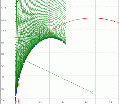

Do you mean the envelope, all the tangents for the range en T?
curvatura5 - envelope.sm (23.64 KiB) downloaded 1547 time(s).
Best regars.
sergio 12/6/2019 5:19:00 PM
