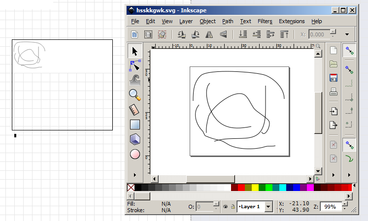

Plugin build updates:
1. On region copy / paste region is copied however filename does not have an extension & on re-opening the workbook file names loose its extensions. - FIXED
2. Now copy / paste generates region with same name, while ctrl drag generates region with new name
3. Image boundaries in the region and in inkscape don't match. There is spurious whitespace to the right. - FIXED
4. Newly created .svg file now scales correctly after being edited in inkscape.
5. when the region is empty, the border does not indicate on/off state (yet the setting seems to be stored, image content seems to be required for the border to show up correctly - Cannot Reproduce, pls attach .sm workbook and explain what is wrong.

Hi All,
So I need some ideas on how to speed up resizing of .SVG containing Image Region.
Currently this is what happens:
- you drag the regions size marker
- with every increment, the .svg image inside renders itself into raster image for display inside SMath workbook.
As you can guess that takes up alot of compute power and is slow.
Feel free to throw in conceptual suggestions I can use to speed things up

Also blank .svg you can insert into image region from context menu works as intended now (if you use .dll from last archive) ;-)
And why did I spend 6 hours of my time so far on this? I would like easily editable sketches in my calcbooks - modifying vector graphics is much easier than layerless raster image.

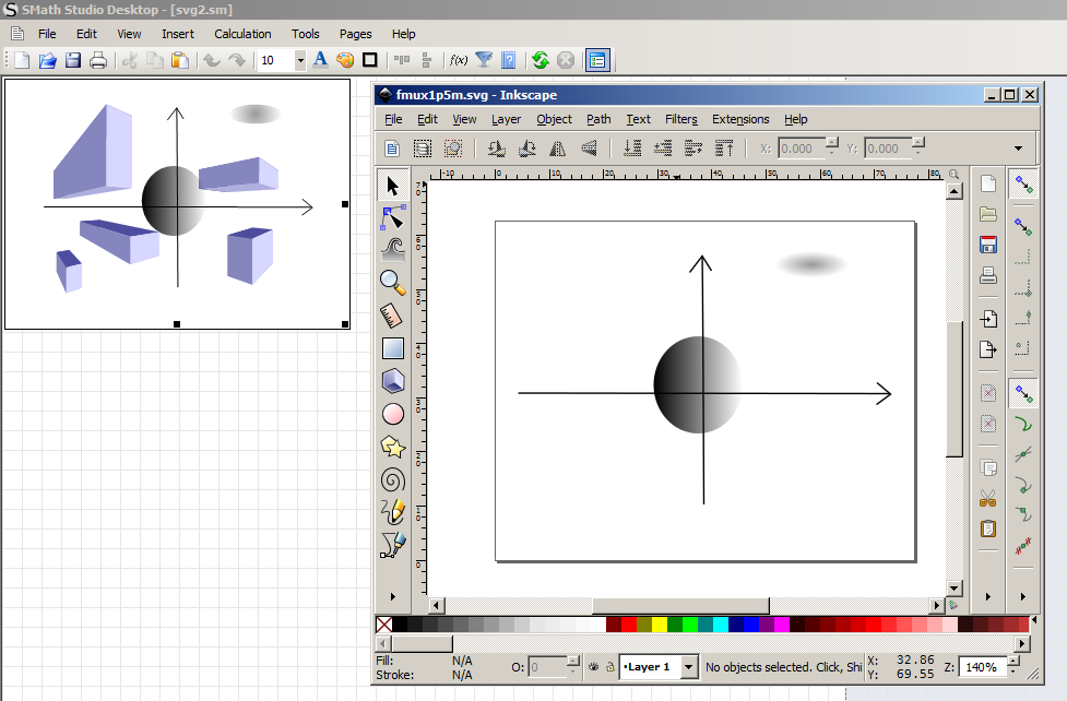

1. Insert> Image
2. try to switch off the image border in the context menu.
this does not work for me, the border is still displayed.
3. If you then create an image (set the format, doubleclick to edit), then the border is removed.
Seems that switching the border state works with an empty region, just the display does not obey the setting.
Another problem:
If I open the image in the attached sm file, then some objects are invisible in inkscape. They all were created with inkscape. The reference points of the 3D projection seem to get lost or modified. Could that be a side effect of the size handling?
svg2.sm (28 КиБ) скачан 1545 раз(а).

2. Smath Image Region does NOT zoom. It spreads the tartine ==> therefore useless.
3. Smath does not transport the Red from QuickPlot. Maybe vice versa: does not read red from QuickPlot.
4. Smath region in native project is a matrix grayscale viewer. NOT a picture operator.
Suggestions:
1. Capture screen via WinGrab [rich in color reduction]
2. Zoom via IrfanView [aspect ratio = or not equal, rich Lanczos zoom].
** IrfanView, WinGrab ==> freeware
Work sheet named easy to retrieve in the context.
1. Wiki is not a reliable source of information. As your statement proves. You actually can export png.
2. You are probably referring to the Picture Region, not the Image Region.
If the sheets you post refer to external files, please make sure to use relative paths, set the current directory to the document directory and include the files in the post. Except you want to demonstrate what happens if file access fails ;-)

Hi All, I probably wont get to work on the image region till weekend, however it is a good idea to think of a roadmap. Martin, to discuss your comments:
I have done this - found no file found error annoying as well after some use (new .dll is not included yet).
<1. Insert Image
this does not work for me, the border is still displayed.>
Unless I am wrong, this is how original image region behaved (I just redownloaded it), do we want to change that?
I am at the stand still here. The plugin only zooms SVG files if no height/width is present inside the file, or if it is set to % (as I did for blank svg). For either of those cases, when inkscape re-opens the svg, the "3D Box" objects were minimized to the bottom left corner (you still can scale them up if desired). If someone can come up with .svg file that both scales in SMath, and is saved/opened correctly by inkscpe I can use it as a blank document in the plugin. It is not a big deal for me though - how often will you sketch those 3D boxes in SMath?
This one is tricky. While there is no intent, per say, I am not sure how to change it either. You see, I can define Clone () though the code, while copy/paste just takes the region and creates the exact duplicate (just like Davide mentioned). And while you can edit the formula you copy/pasted, you cannot redefine the filename of the image in the region from SMath. Davide, do you think there is a conceptual way to change the name of the imbedded image during copy / paste? I cannot think of one..
Will try :-) update / resize functions are used throughout the code and it will take some effort to seprate the two (i.e. resize without re-rendering of svg, unless certain condition). It should be possible, the question is whether I will be succesful at it.
Also I am getting close to the point where I wanted to be for the Image Region development (once I take care of the above, if it proves to be possible / necessary). Do you guys have any major griefs with it, or suggestions? Otherwise I wil wrap it up and publish to the extensions manager.
#60 Опубликовано: 03.02.2016 12:35:44
Great.
Цитата
<1. Insert Image
Switching off the border of an empty region would imply the danger of having an invisible region. On the other hand, offering to switch off the border and not to reflect the change is inconsistent user experience. One solution would be to grey out the border switch as long as the region is empty (if it is just filled with a white image, that would do as well. Then the region is visible if you have the grid on.
I don't care the 3D objects. Yet this is a limitation which should be mentioned in the doc and kept in the bug list.
I am happy with Ctrl-Drag. However, it will be hard to explain that to new users (I give a getting started course to my students every year).
It is acceptable. Anyways, most people will use the region for quick and dirty illustrations of moderate complexity. I generally vote for doing the annotations with overlaid math regions. This keeps the sketches simple and the annotations consistent with the worksheet.
Looking forward to your upload. Maybe, it's triggering a new unofficial portable version, including an update of the help page for the image region.
