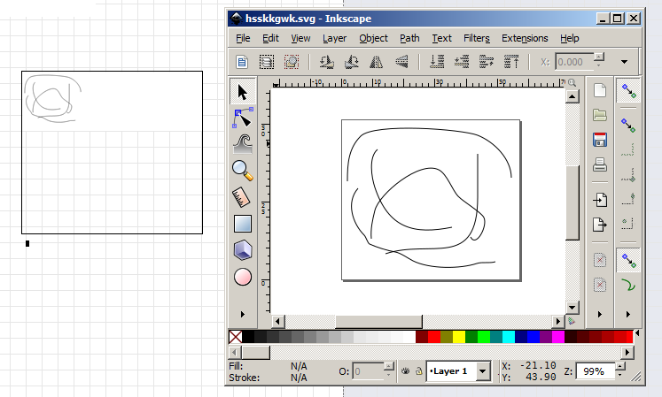

My 4th revision of the plugin.
On region cloning (ctrl is pressed) region is duplicated with new filename
On region copy / paste region is copied however filename does not have an extension (have no clue why, code is attached if you decide to dig around). Fix - right click and select desired extension
SVG does scale, however not in a way I would like it to (like a raster image)
If you have time please test - must catch bugs before sending it to repository
ImageRegion.004.zip (290.76 KiB) downloaded 536 time(s).
Major deficiency - on re-opening the workbook file names loose its extensions. I'm sure its set to happen so in the code - I just need to find where/how does the region store its filename.
Also will likely have to leave svg non scalable for now - raster scaling is just plain wrong.

- when the region is emty, the border does not indicate on/off state (yet the setting seems to be stored, image content seems to be required for the border to show up correctly
- Image boundaries in the region and in inkscape don't match. There is spurious whitespace to the right.

1. On region copy / paste region is copied however filename does not have an extension & on re-opening the workbook file names loose its extensions. - FIXED
2. Now copy / paste generates region with same name, while ctrl drag generates region with new name
3. Image boundaries in the region and in inkscape don't match. There is spurious whitespace to the right. - FIXED
4. Newly created .svg file now scales correctly after being edited in inkscape.
5. when the region is empty, the border does not indicate on/off state (yet the setting seems to be stored, image content seems to be required for the border to show up correctly - Cannot Reproduce, pls attach .sm workbook and explain what is wrong.
Side note - Martin, should I create a separate thread so this thread does not fill up with my frequent build updates?
ImageRegion.005.zip (271.01 KiB) downloaded 499 time(s).

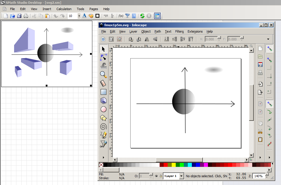

Another problem:
If I open the image in the attached sm file, then some objects are invisible in inkscape. They all were created with inkscape. The reference points of the 3D projection seem to get lost or modified. Could that be a side effect of the size handling?
svg2.sm (28 KiB) downloaded 1545 time(s).

Image Martin svg2.sm (206.93 KiB) downloaded 1594 time(s).
#58 Posted: 2/3/2016 6:33:33 AM
1,361 likes in 2,275 posts.
Comments:
1. "Inkscape" current save formats are (at least): Inkscape SVG(Z), Plain SVG(Z), PS, EPS, Cairo PDF, Cairo PS, POV, ODG, TEX, AI (8.0), DXF, AutoCAD DXF, EPSI, GPL, XCF, XAML, Inkscape svg with media ZIP, EMF. [Wiki Info].
==> does not save as *.bmp, *.png ==> therefore not compatible with Smath File Access.
==> Argument closed
2. Smath Image Region does NOT zoom. It spreads the tartine ==> therefore useless.
3. Smath does not transport the Red from QuickPlot. Maybe vice versa: does not read red from QuickPlot.
4. Smath region in native project is a matrix grayscale viewer. NOT a picture operator.
Suggestions:
1. Capture screen via WinGrab [rich in color reduction]
2. Zoom via IrfanView [aspect ratio = or not equal, rich Lanczos zoom].
** IrfanView, WinGrab ==> freeware
Work sheet named easy to retrieve in the context.
1. Wiki is not a reliable source of information. As your statement proves. You actually can export png.
2. You are probably referring to the Picture Region, not the Image Region.
If the sheets you post refer to external files, please make sure to use relative paths, set the current directory to the document directory and include the files in the post. Except you want to demonstrate what happens if file access fails ;-)
