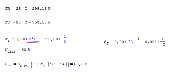

How to compute this
#6 Опубликовано: 10.11.2020 12:20:49
The problem is due to the internal storage of the program in Kelvin. You find several threads in the forum. you can also find an explanation in Martin Kraska's interactive guide (Tools menu -> Options -> Plugins -> interactive books). However the solution is to use DeltaC °
Davide Carpi 12.11.2020 10:10:00
#7 Опубликовано: 12.11.2020 09:04:06
Int16
Int16
0 сообщений из 9 понравились пользователям.
Thanks a lot.

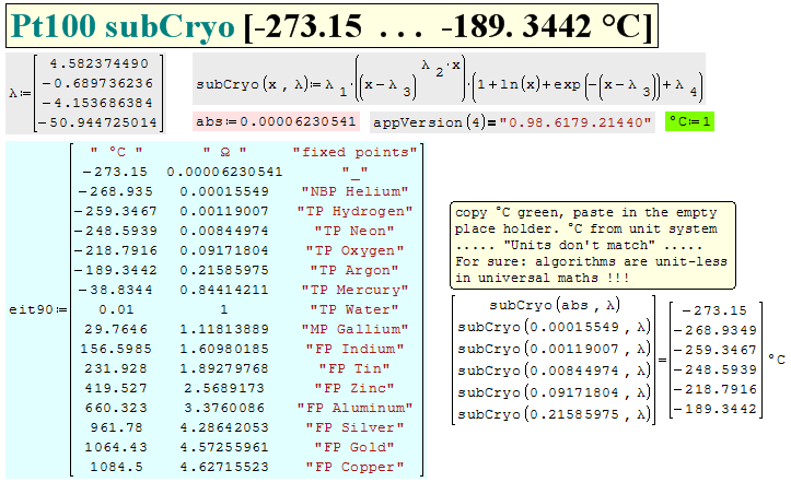

#8 Опубликовано: 12.11.2020 10:30:53
... you can make the unit system silent, i.e: inactive
#9 Опубликовано: 13.11.2020 17:55:49
This is close to recommending pencil and paper.
#10 Опубликовано: 14.11.2020 08:49:14
Pretty close Martin, that's ± what QA sanity check does.
The mV/I temperature converter reads mV ... then displays °C.
In parallel to the black box mV/I, read mV, interpolate wrt NBS [now NIST].
#11 Опубликовано: 14.11.2020 14:24:48
wrong display of output units
You will have infinitely many of those, easy to doctor:
1. make the system silent, though not quite paper/pencil
2. make it user style at will.
