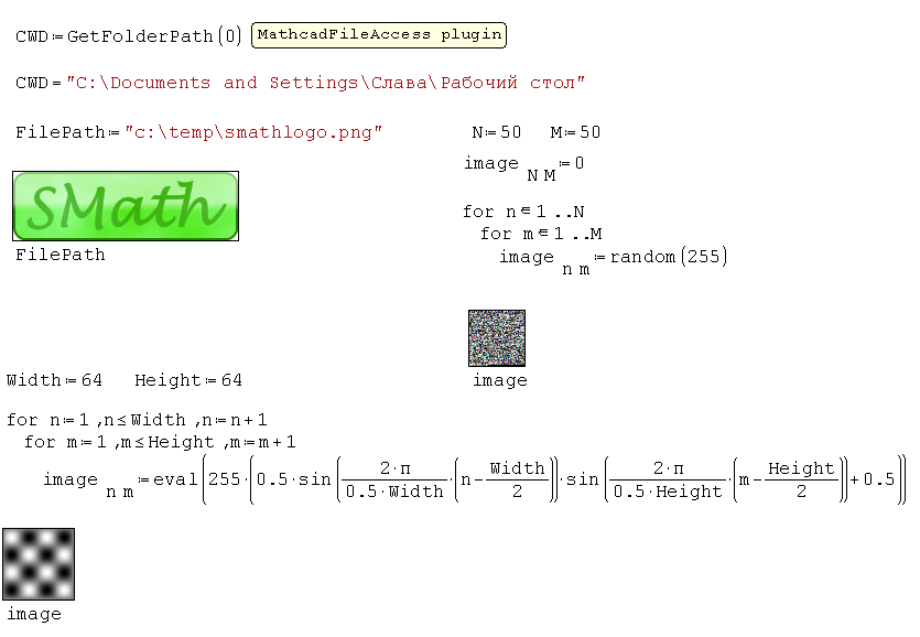

Extends SMath Studio with an Image Region.
Показать спойлер

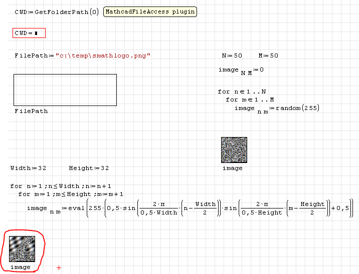

Plugin works, except for Mathcad file acces, which I have not installed yet. Also, I did not test the image import.
Resizing requires just to touch the handles, then the size jumps to correct value. One has to be careful with image size, using 128x128 for the second image, Smath crashed when I tried to rename the variable image.
Also, there seems to be an indexing problem. For some sizes, the result of the second computation does not overwrite the upper left rectangle as expected but has some shift. Don't know if that is due to the formula or due to the plugin.
#7 Опубликовано: 02.05.2013 18:36:06
Yes, it's strange. I'll see what's up. I need more sleep.
P.S. We have to change the names of variables. We use the same variable image.

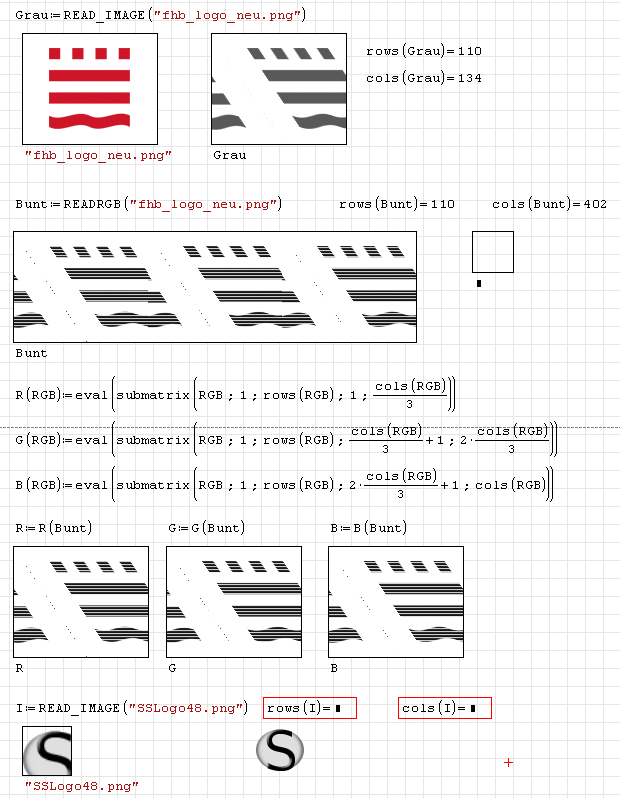

I did some more testing in connection with MathcadFileAccess.
The image region produced artefacts with data read by READRGB(). It seems that from a certain point there is a shift in pixel indexing. Graylevels read by READ_IMAGE are displayed correctly, just as images from files.
The problem does not occur with the win logo from your MathcadFileAccess Examples. It, however, persists if I save the fhb logo in different formats, including various tastes of bmp.
Also, the SMath logo as available at the download section in the forum is not displayed correctly. READ_IMAGE fails to read it at all.
P.S. I also noticed that I cannot put a function call to the placeholder but have to assign a matrix in advance.
P.P.S: The gray level image has slightly colored shades in the image which are obvious in high zoom levels. I can't tell if that is a READ_IMAGE problem or an imageregion problem.

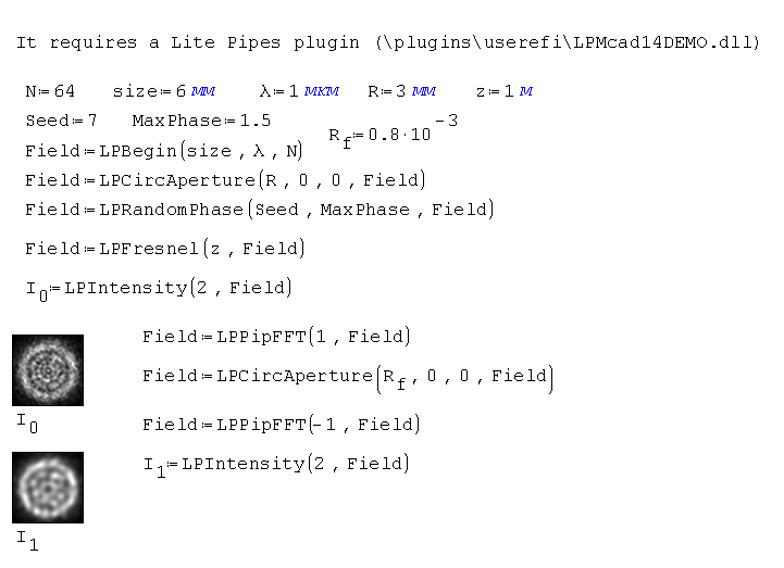

P.S. LitePipe Demo example.
LitePipes_20130504.zip (1,33 МиБ) скачан 620 раз(а).

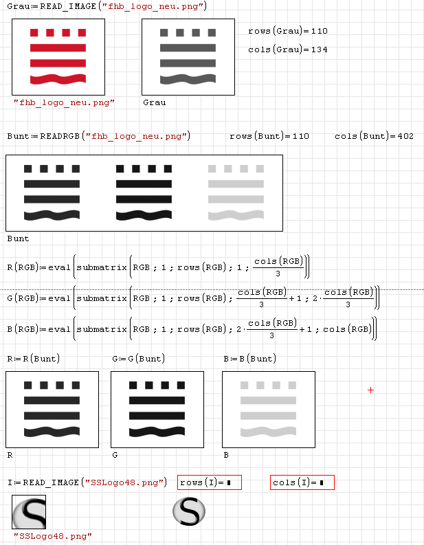

After updating both MathcadFileAccess and ImageRegion:
- The imageregion example works fine.
- The image examples in the MathcadFileAccess examples dir have no images included.
- There is a hardwired local path from your computer in the writebin example. If changed to currentdir everything works.
My examples, however, do not work.
- The vertical offset of the lower right image triangle has gone
- The colorful artefacts in the graylevel plots have gone
- Now, there is a more obvious horizontal shift in the image
Do i have to assume that my test image is buggy? It is the very expemsive new official logo of our school, taken from the website.

You are right, It was my fault. I failed to complete the update by moving the dll...
Now just the smath logo seems to resist the debugging effort.

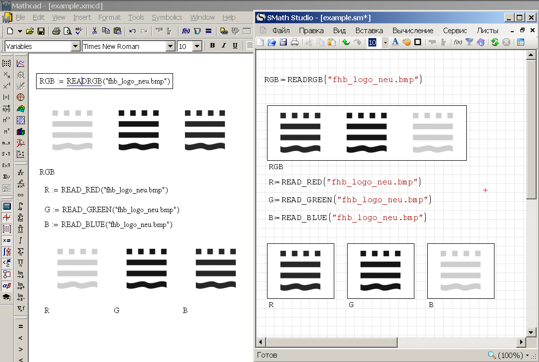

I compared the results with Mathcad and I think I swapped the colors (I'll read the Mathcad Help).
#14 Опубликовано: 04.05.2013 15:13:00
Updated. Now colors not swapped. Small improvements.

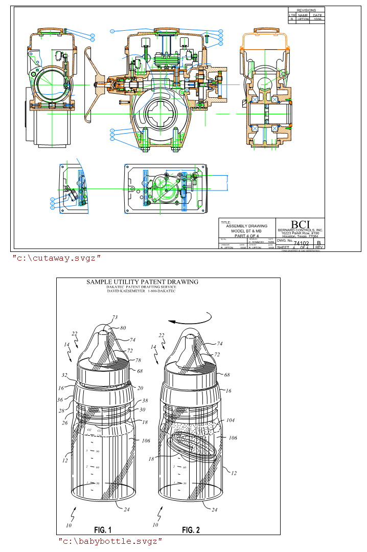

Updated. Added support for svg.

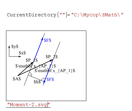

I cannot display the attached image (had to zip the image because svg is not allowed as attachment file type). The file is generated using TpX and cleanly displays in IE.
Also, after downloading the plugin, further access to the online gallery is denied. This also happens with Davide's Conditionally Formatted Label but not with Andrey's Excel Files Plugin.
Tested with the installer version of 0.96.4909 using plugin version 1.0.5033.22634
No such access problems with the portable version. The display problem is present in both versions.
Moment-2.zip (1,09 КиБ) скачан 546 раз(а).

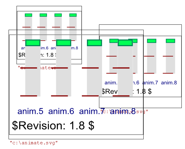

#17 Опубликовано: 12.10.2013 09:51:48
Updated. Try now.
Martin Kraska 12.10.2013 10:04:00
#18 Опубликовано: 12.10.2013 10:08:30
Confirmed for installer and portable version, works now. Thanks a lot.
Gallery access issue remains, but might have causes outside the plugin.
PS: how about an optional background? The grid is visible through the image, which is close to paper-and-pencil-feeling, but which might be a matter of taste -> optional setting would be fine.
